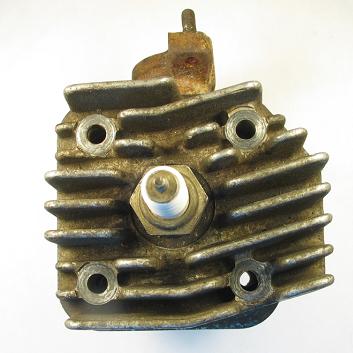

The Honda manual Section 6-3 has a photo, but might as well post one... sooner or later I will remember it by "the tab goes on the back right hand side", or "the angled fins go on the fan side".

Thanks a lot for the picture. It answered my question.

Yes in the manual 6-3 shows the head like this but, 6-0 has it the other way.mousewheels wrote:The Honda manual Section 6-3 has a photo, but might as well post one... sooner or later I will remember it by "the tab goes on the back right hand side", or "the angled fins go on the fan side".

6.0 is a drawing and never trust a drawing, mainly because an artist drew it. 6.3 is a real picture of an engine, believe it. And again the IPB (Illustrated Parts Breakdown) is a DRAWING, a good one even but it is a drawing, don't trust drawings for assembly purposes.Gingerbread Man wrote:Yes in the manual 6-3 shows the head like this but, 6-0 has it the other way.mousewheels wrote:The Honda manual Section 6-3 has a photo, but might as well post one... sooner or later I will remember it by "the tab goes on the back right hand side", or "the angled fins go on the fan side".

I must admit that I fell victim to the artist's drawing for the head as well. I had it on backwards for 3 tanks of gas and had no issues. When I saw this thread the other day, I knew I had made a mistake. Took it all apart today and put the head on correctly. Was nice to see how clean and great everything in the cylinder/head still looked after 3 tanks of gas. My plug was perfect chocolate brown too
Moral of the story - it will run with it on wrong, but I dont know if it would cause long-term damage due to the possibility of it not cooling correctly with the fins in the wrong position. Can anyone confirm?

MY cooling plastics don't really fit the other way around.
I have been running my spree heads the wrong way for over a year now.

Bear is absolutely right. I asked my instructors at school today and they said go with the picture of the assembled bike. Not the drawing. I was also installing them backwards on my Spree w/out a problem though. I fixed mine today.
