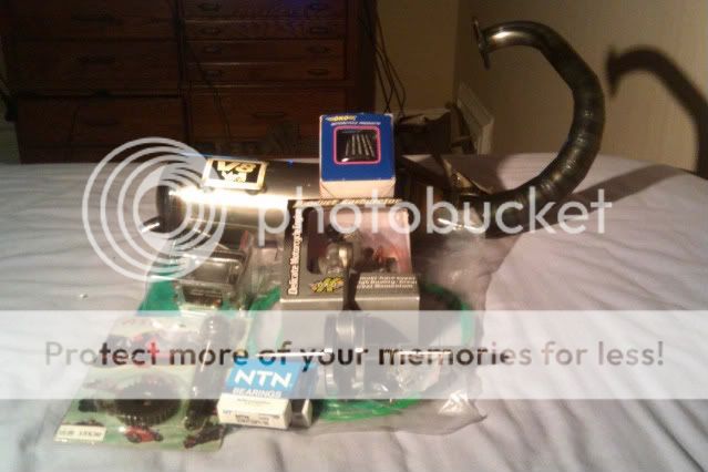

so i got out of work tonight stop by my dads how to pick up my stockpile of new parts for the elite s i picked up off of trafficjamz now the list as is!
50mm bbk (taz is the man)
28mm oko and intake kit
44.4mm mini stroker crank
29mm V8 exhaust
6.9:1 primary gears
prodigy vari w/6g rollers
1,1.5,2k clutch springs/torque springs
although i only have a picture of what i just got tonight the rest is out at trafficjamz shop waiting to be put togeather
