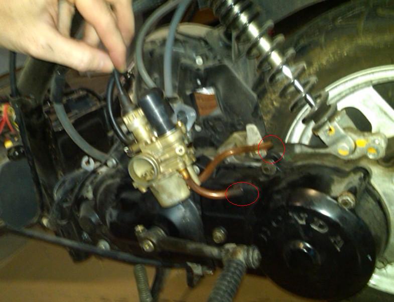

Trying to get my friends 1994 50cc running correctly. He told me there was a cracked fuel line and it was leaking, so he parked it and has not touched it for about 8 years!
I put fresh gas in and used the battery from my car... to my surprise it started up rather easily. Lots of smoke from old gas in the lines, but started none the less.
I was greeted with a fuel leak coming from under it, from the belt drive cover. Also notice gas leaking from the line that goes to the black plastic housing on top of the carb. I blocked that line temporarily to see if that was the only leak, and there is still a fuel leak somewhere (from underneath). I pulled the carb off to have a better look at the lines, and nothing appears to be dry rotted or cracked. Could the carb be flooding for some reason?
If I do a simple carb cleaning, is there anything else I should look for that is known to cause leaks on these? I will of course change the plug, clean air filter, and change the oil.
Also noticed there are 2 short lines from the carb that were not connected to anything. (Red circles) Both drip gas while handling the carb. Are these vent lines? Should they be attached to anything??? :?:

Those are both over flow vents lines which means your needle and seat are not seating, you float is either mal adjusted or not floating. In either case the carb comes off and apart.
Oh and it is a two stroke, oil injected, so make sure you use injector air cooled 2 stroke oil. If you disconnect the oil lines you have to make sure you don't have any air in them when you reassemble it.
