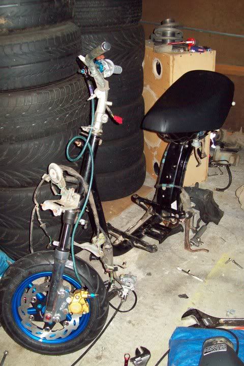

I think its time to share my race bike build.

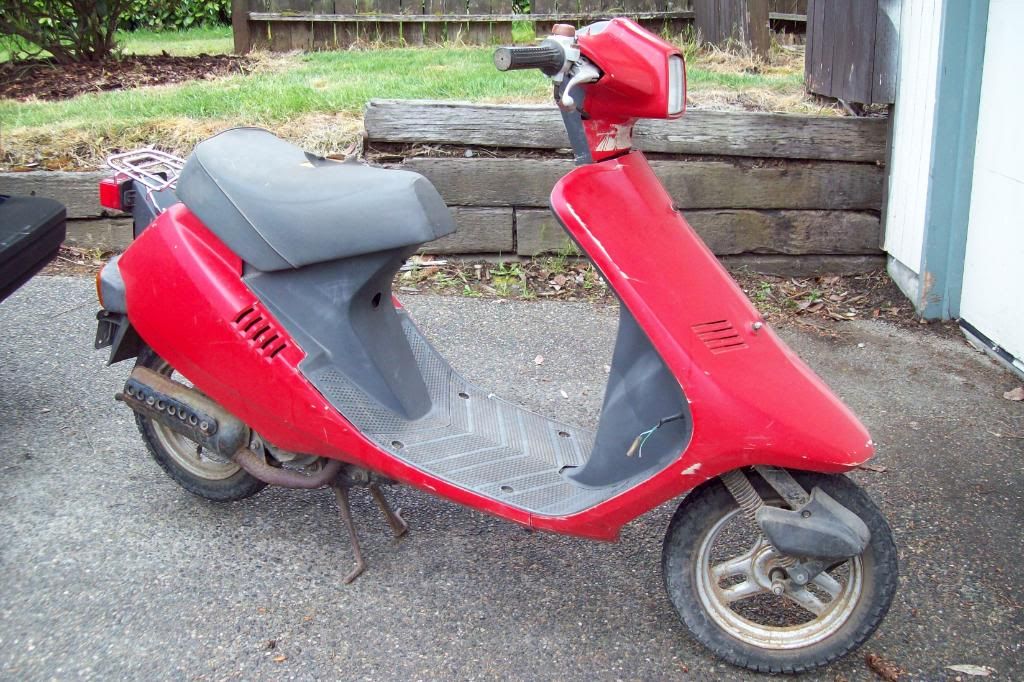

this what is started out as

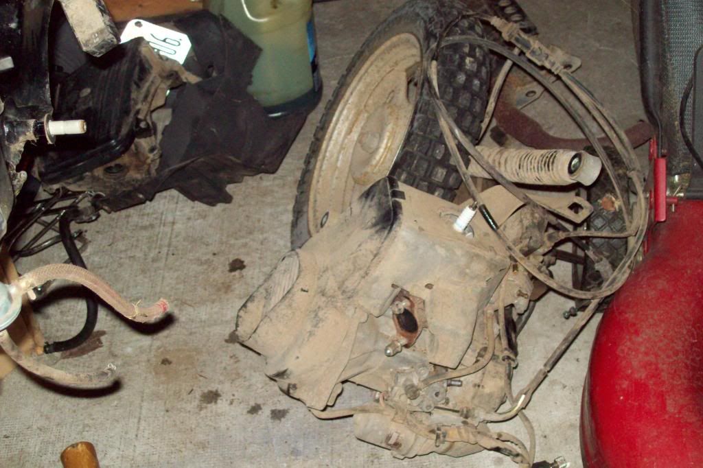

this what the motor looked like. lots of caked up dirt.

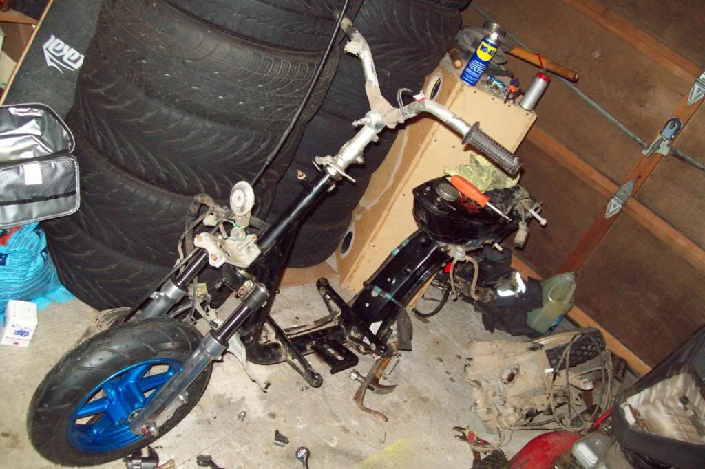

stripped to the frame to check for cracks or bends and to clean up.
Nothing like getting stroked!

Looks like that thing was buried in some mud when you found it. Good thing it found its way into your hands. Looks good so far :thumbsup:
What kind of front end is that off of?

the guy I bought the bike from lived on a dirt road. his grand kids road that thing on there alot. the triple tree is from a live dio zx and the legs are from a kymco. Its a plug and play setup. no mods needed for it to work.

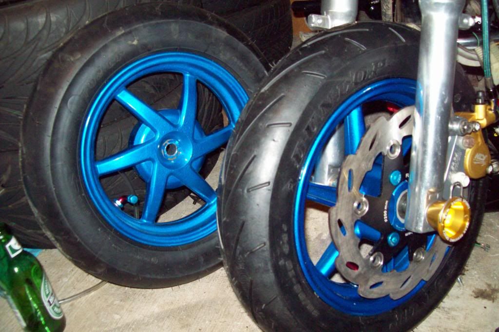

is there a difference between the steel braided and reg. brake lines?

yeah the steel line doesn't flex as much so the brake feel is much more firm when you squeeze the lever.

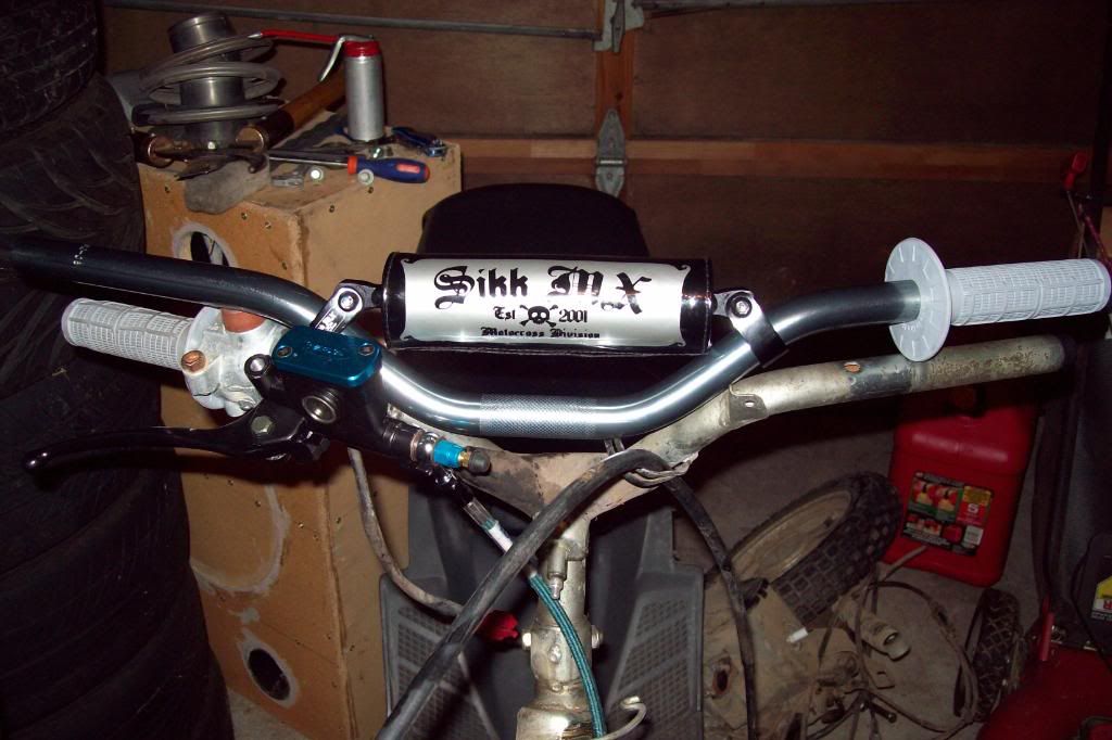

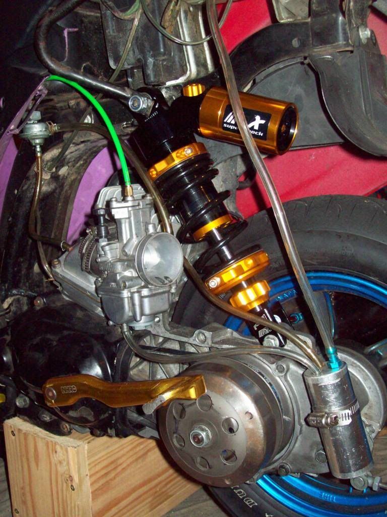

Here is a little update on my bike for next season. custom made rear shock to my specs. 265mm length and spring and internals set to my weight and bike weight. this is a 3 way ajustable shock. spring preload, rebound and compression adjustments.

whats the aluminum cylinder with the fuel lines going into for?

tw39515 wrote:whats the aluminum cylinder with the fuel lines going into for?
fuel catch can. its required to race at any track so you dont leak premix on the track. its a intake boost bottle. on the bottom is the original threaded hole that I use as a drain plug and I drilled 3 holes for the hoses.
