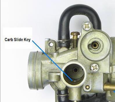

HELP! Which is bad.When I look down the throat of the carb,and turn the throttle handle,the throttle valve does not move.But the I see the the end of the throttle cable going up and down.Do I have a bad valve or cable or both.I have taken the carb apart and cleaned with same results.
Posts: 3485
Re: 1986 honda spree throttle valve
Sounds like your throttle slide is hung up in the 'open' position. The slot in the throttle slide, (see previous pic) needs to line up with a small key inside the carb.

OK throttle valve is fixed.Engine is running but I have gas coming out of a tube on the bottom of the carb bowl,any ideas.Thanks for your help,I'am going to get this thing right yet.I did take the carb apart and cleaned it did I do something wrong,putting it back together? I was very carefull.
Posts: 3485
Nice recovery - sometimes a heavy hand tightening down the throttle cable top assembly mushrooms that keying pin.
There are two tubes which may flow gas - the bowl drain, and the overflow. If it's the overflow - pull the carb bowl, clean and check the float needle. Some bits of crud may be impeding proper seating. The seat itself can cause problems, search this site on 'minty fresh' to find a typically humorous, and insightful repair from Wheellman-111.
If the bowl drain, unscrew the needle at the 3 pm position in the photo, and figure out why the carb bowl drain is leaking.
