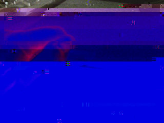

Steps to hook up flatslide cable steps 1-3
- Cable end through plastic piece
- Cable Through Plastic.JPG (38.51 KiB) Viewed 11129 times
- Recess in Slide
- Recess in slde.JPG (43.8 KiB) Viewed 11130 times
- Cable end goes through slide
- End through Slide.JPG (45.82 KiB) Viewed 11131 times

Steps to hook up flatslide cable steps 4-6
- Start the plastic piece back in- make sure the cable end is still held by shoulders in slide recess
- Start Plastic Piece In.JPG (48.27 KiB) Viewed 11131 times
- Plastic peice almost seated (goes over cable end)
- Plastic Piece almost Seated.JPG (39.41 KiB) Viewed 11130 times
- Finished cable attachment- put slide back in carb
- Finished.JPG (52.27 KiB) Viewed 11130 times

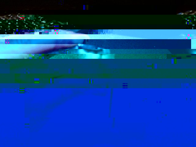

I got a couple pics to day.

Here's a pic from another site showing the white cable retainer being slid into position:
- Oko_slide_keeper.JPG (13.92 KiB) Viewed 10986 times
