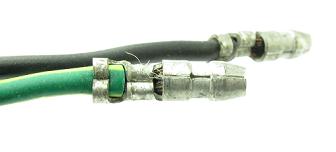

Male bullet terminal.
  • You could try a post in for sale/wanted and someone may be able to cut some off an bad harness or even sell a harness. With a harness, the needed length of wire may be present.
  • There's an aftermarket source of bullet connectors a member found - http://www.vintageconnections.com/ Takes a bit to find the part. First click on the "Price List" link from the home page. Then scroll down and look for "SB2". I think its the correct part - but have never ordered from them.
Here's a pic of the Honda contact for comparison
