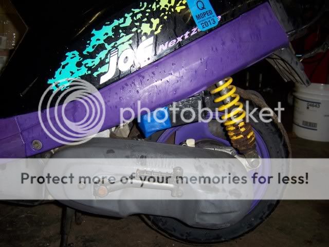

My friend just picked up a 1996 yamaha jog for $400
He wants it to go very fast. :smile:
What parts should we buy for it?
Are there stroker kits for the jog?
I am new to the jogs and do not know where to start.
