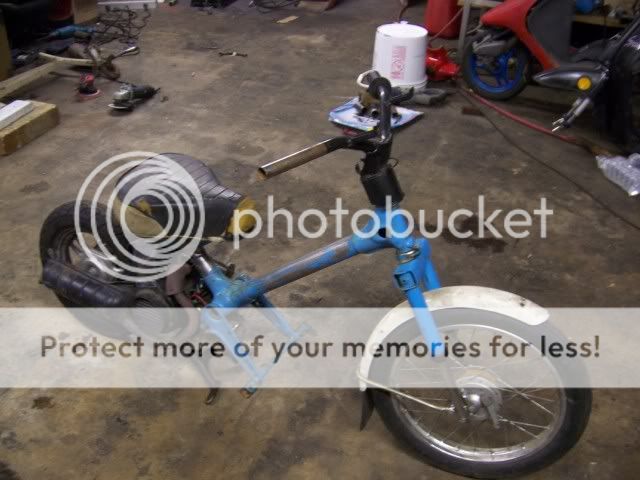

My six year old wants a scooter of her own.
But she is too small to fit on a spree.
So I am customizing a Honda express to fit her.
This is what I have so far.
