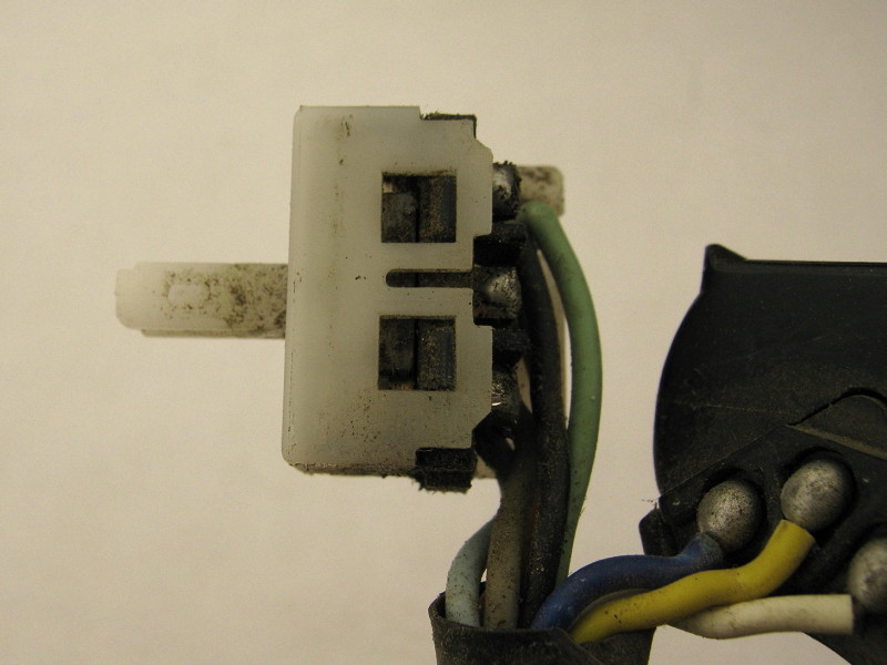

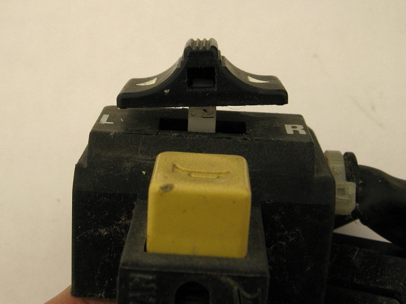

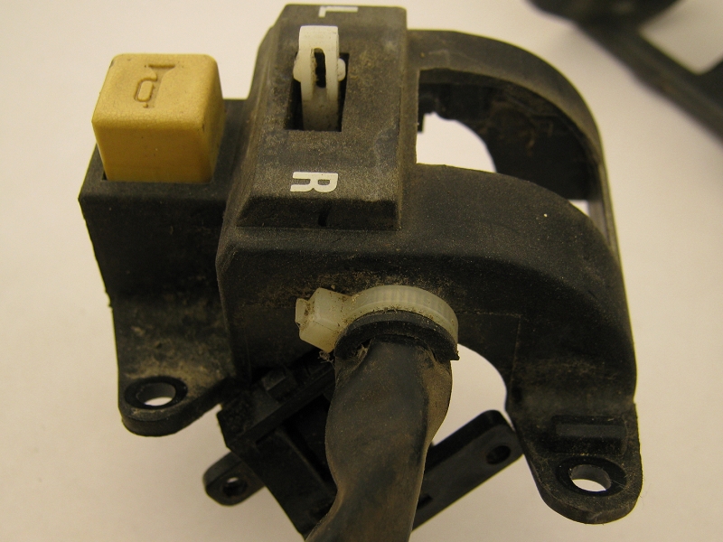

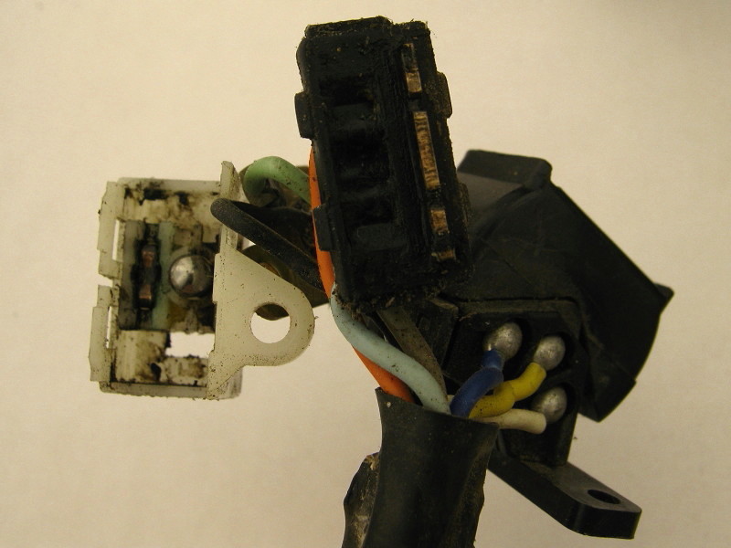

You can start by releasing the tabs holding the switch actuating knob from the switch and inspecting and cleaning from the top (3rd, 4th photos)
If needed, you can disassemble the whole switch and clean it.
