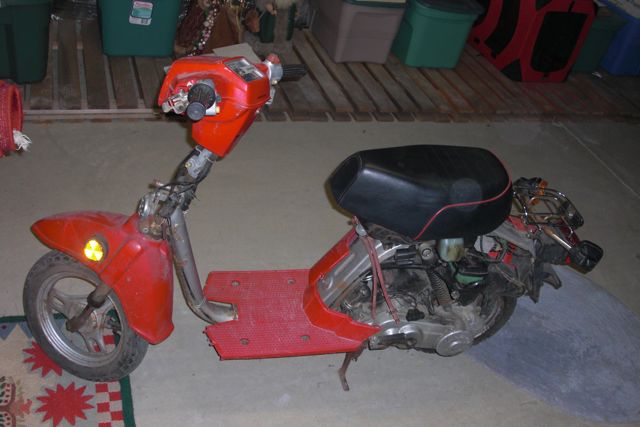

Hi Friends!
My name is Jerome, I live in upstate NY and just purchased a Spree locally this past weekend(still have to check the year, but it has a kick start, so its later). I have owned a Tomos Targa Moped for about ten years and done my own maintenance for the last five. I am mechanically inclined, enjoy projects and learning new things. When the project is done the spree will primarily be ridden by my girlfriend. I look forward to contributing to the community.
I have been watching the local market for one in fair condition for a few months, this one came up on Craig's List $200 OBO, it looked pretty good in the pictures and sounded good on the phone, borrowed gradma's Honda CRV and drove 40 minutes to pick it up. It was a little rougher upon closer inspection, but still not too bad and only 1,576 miles. The owner said it was running until they took the carb off to clean it, then when they put it back on they could not get the throttle set right and every time they started it, it would be running way above idle. I ended up taking it off their hands for $75.
My goals are to get it in 100% mechanical working order, clean up the built up grunge and polish up the plastics.
Below are the photos once we got it back to the basement and the preliminary list of parts that I need/want to replace, I would like to pick up used where applicable. Let me know if you see something from the photos that should be taken care of too. I am sure I will have questions once I start to dig into the project!
Jerome

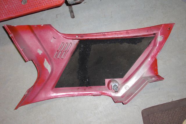

More photos...
corrosion?
corrosion?
A little rusty, possible to repaint with grill paint?

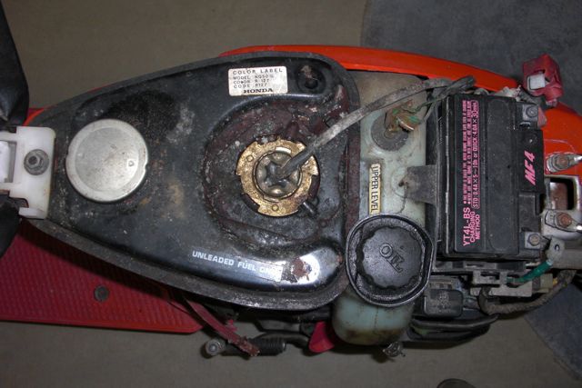

Oil leak?
Oil leak?

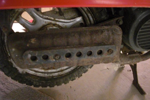

A little rusty, is this okay on the outside?  Previous owner said they cleaned the inside...
Are these bent in more than normal?

First of all welcome and nice score! That pic of the oil isn't likely a leak, I would say the oil tank was overfilled or cap left off.

welcome!! :smile: and good find, yes your turn signals are really bent, might want to put a rear rack on your list of needs, and i agree with martynkim looks like an 86

odinxxix wrote:welcome!! :smile: and good find, yes your turn signals are really bent, might want to put a rear rack on your list of needs, and i agree with martynkim looks like an 86
Yeah, those signals should be straight. :surprise:

If they aren't rusted thru, try banging them back into shape with a rubber hammer.

Thank you for the leg shield offer, I have all the plastics and they are in good condition save a few scrapes, I just have to read up on how to brighten them some.
I will try to bend the turn signals back out, I have no idea how they did that, there is only mild surface rust as expected.
Good news on the oil spill, I will wash out the foam.

Front plastics, one of the worst plastic spots is that bend you see on the front fender

your small front plastic is upside down, you should just cut your turnsignals off it looks way better, and marty and kim is the man to talk to for parts great guy!

Thanks for the upside down note... I just set the two pieces in place but not locked in to get the picture.

Today I went to work on it some and wanted to re assemble the carb, they PO said they cleaned it but I was skeptical so I disassembled and cleaned it up, I think it looks good now. I checked the service manual for the assembly scheme and it looks like I am missing the retaining piece for that gold pin. I received the carb in that red towel disassembled from the PO and the retainer was not in there. Lets play name that part, I think the two large bolts hold the carb back on to the body, the spring is for the throttle, the collar goes with the gold pin, then I am not sure where the little screw and the two other parts fit in.
I also took the exhaust off so that I can replace the rear tire, it sounds like there is a bunch of carbon built up in there, surprising since the odometer is only at 1500 miles, I noted some carbon build up on the outlet where the muffler bolts on to the cylinder head, I will read up on how to remove.
