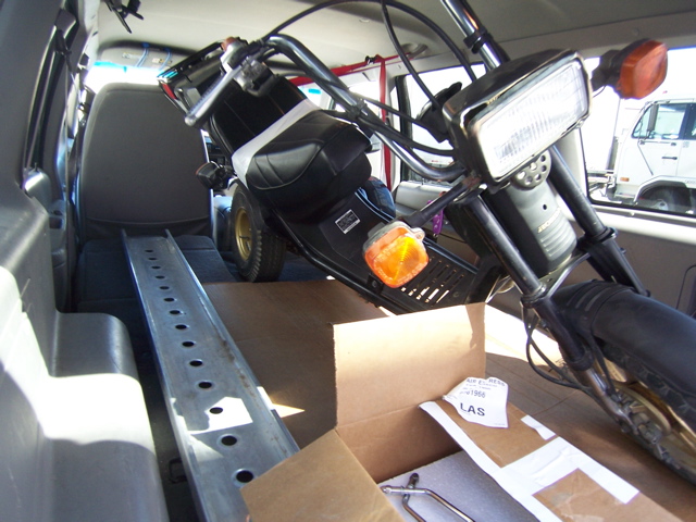

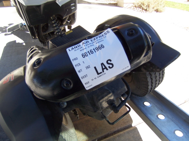

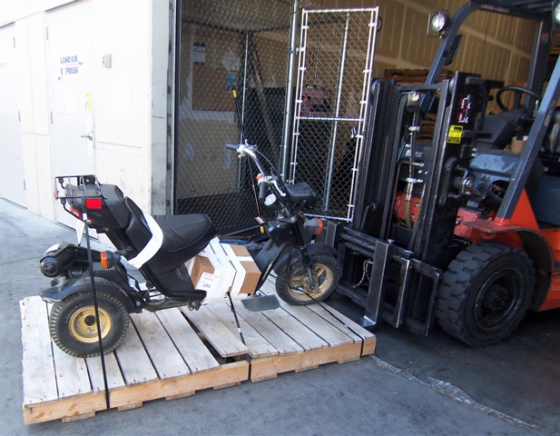

Hello well my 85 Gyro is done ,well OK needs decals /trunk/windshield installed no big deal
- Pick Up at shippers
- 100_6523.jpg (182.23 KiB) Viewed 10188 times
- Fit in the back of a SUV
- 100_6533.jpg (164.83 KiB) Viewed 10188 times
- Unloading
- 100_6557.jpg (132.05 KiB) Viewed 10188 times

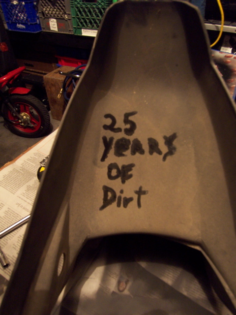

- 25 years of dirt and some rust damage .
- 100_6824.jpg (134.48 KiB) Viewed 10187 times

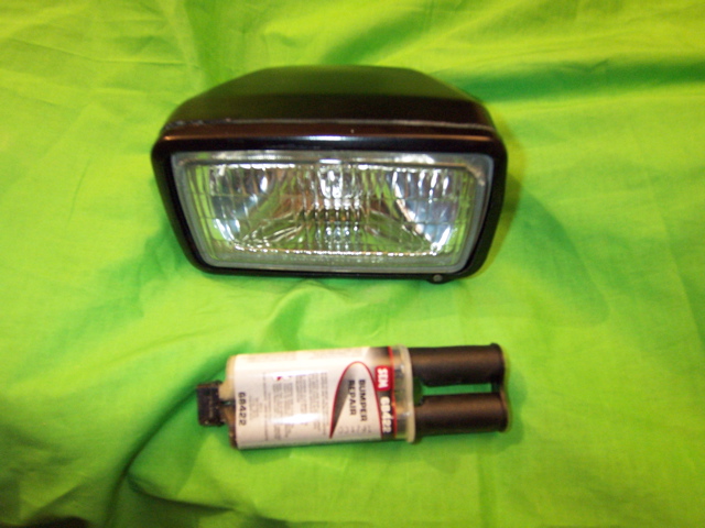

Found some stuff for fixing bumpers figured if it works on bumpers ,it will probably work on headlights and plastic .
- Not perfect but passable.
- 100_9623.jpg (132.41 KiB) Viewed 10183 times
- Had to mold the missing peice used aluminium tape then put the mix in from the inside .
- 100_9592.jpg (147.4 KiB) Viewed 10183 times
- I used Mothers Back To black on the plastics and seemed to work quite well .
- 100_6718.jpg (182.88 KiB) Viewed 10181 times

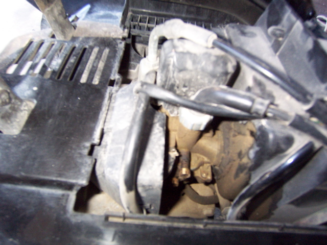

More dirt
- 100_6817.jpg (154.48 KiB) Viewed 10176 times
- 100_6874.jpg (147.6 KiB) Viewed 10177 times
- 100_6876.jpg (171.23 KiB) Viewed 10176 times

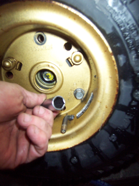

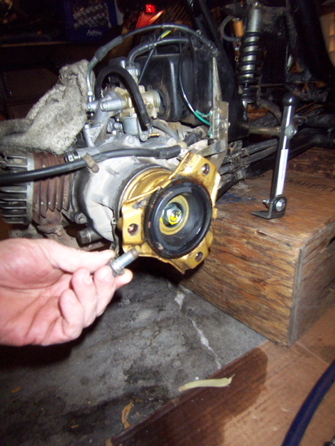

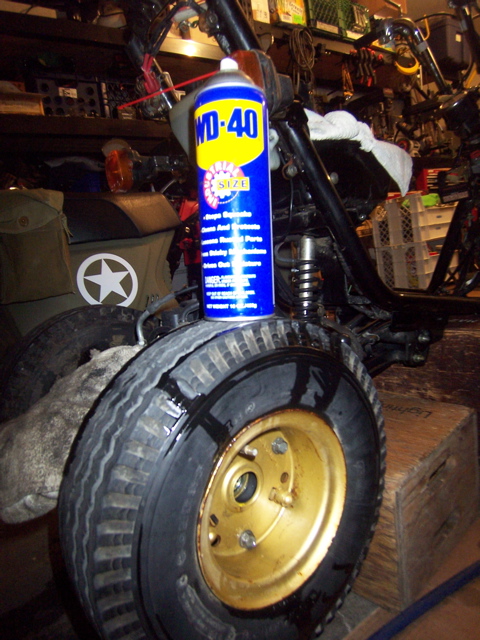

Back to rusty bolts aaaaaaaaaaaaaaaaah more WD40 I would spray in the morn. then again in the aft. then again at night for 3 days ,it was like the bolts were welded on ... Finally I heard that click sound OK got 1 off 5 more to go ....on the last one it felt like the bolt was stripping so I tried a wrench but was in a tight spot (rear wheels ) back to the socket again spinning no grip check out the pics to see what happened ....
- WD40 couldn't have done it without it .
- 100_9837.jpg (195.05 KiB) Viewed 10167 times
- The Craftsman socket split (yes they gave me a new one )
- 100_9861.jpg (134.67 KiB) Viewed 10166 times
- OFF only took 3 days and a trip to Sears .
- 100_9902.jpg (181.07 KiB) Viewed 10166 times

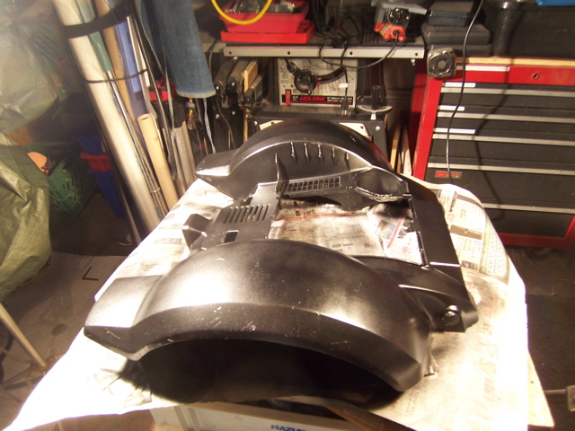

More plastic work ... the fender looked like a dog took a bunch of bites out of it / its hard to see in the pic but it was a mess I had 2 sets of fenders so I thought I would give a shot at fixing one .Took off the decals then I tried sanding took the finish off /No big deal / but still a bunch of deep bite marks ... Then I took a wood burning tool and using the hot round stick part I tried melting the bites .... actually worked pretty good then used the bumper repair to fix some cracks ... let it dry overnight then back to sanding got better and better then wet sanding ... then the bulldog adhisive so the paint would stick ... then paint yes a rattle can I just cant see spending 20 bucks to paint 1 fender with a spray gun .
- OK ready to fix a fender
- 100_6923.jpg (150.55 KiB) Viewed 10164 times
- I thought if I mess up one I will have a second shot at it
- 100_6927.jpg (148.33 KiB) Viewed 10164 times
- done with the fender .
- 101_0012.jpg (160.04 KiB) Viewed 10165 times

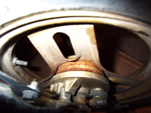

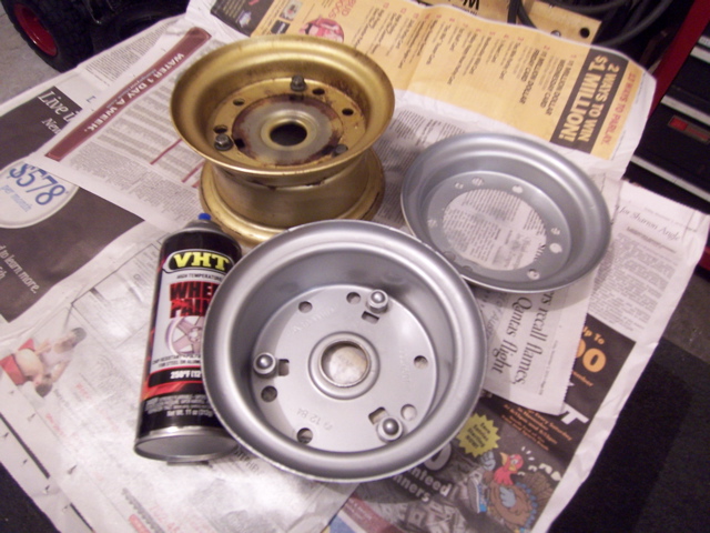

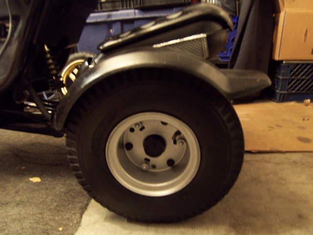

Wheels why did HONDA put gold wheels on a black Gyro ?
I guess its a 80's thing groovey man. I could not stand the gold wheels ... I was going to paint them black but thought it would be too much .
So Hi Ho silver it is .
- Rims Done
- 100_0082.jpg (130.43 KiB) Viewed 10165 times
- For the front I just let the air out and stuck some card stock around sssst sssst done
- 100_9927.jpg (158.96 KiB) Viewed 10165 times
- The rear rims were easy ,after you get the bolts off ...
- 100_9907.jpg (163.67 KiB) Viewed 10164 times

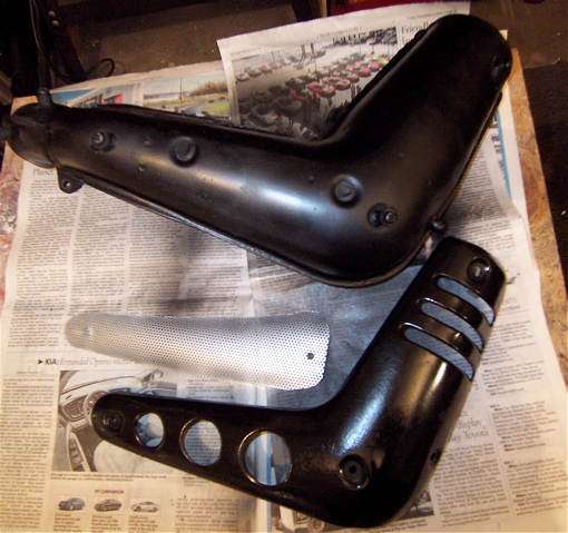

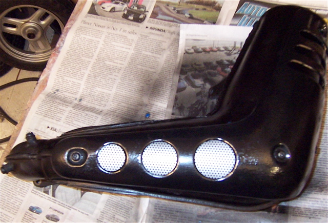

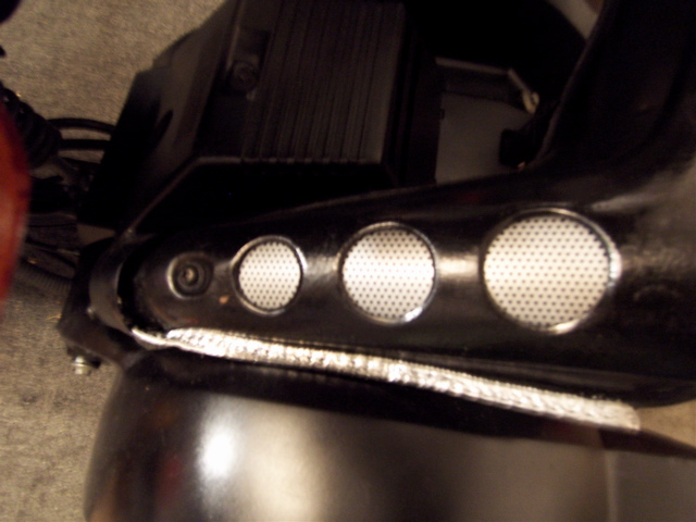

On to the muffler .... I was going to try to keep everything stock ... But had some screen laying around and thought ??? Why not ?
OH 1 thing in the last pic it looks like aluminum foil on the side of the muffler . Its actually some hi-tec from Austraila that disapates heat and you can easily mold it to fit the problem is befor the muffler would get hot and start to melt the fenders .I will see if this stuff really works ?
- cut a metal screen to fit .Jammed the screws in done .
- 100_9991.jpg (154.94 KiB) Viewed 10158 times
- ready to stick on bike
- 100_9993.jpg (166.17 KiB) Viewed 10154 times
- Installed on the bike
- 100_0086.jpg (119.28 KiB) Viewed 10153 times

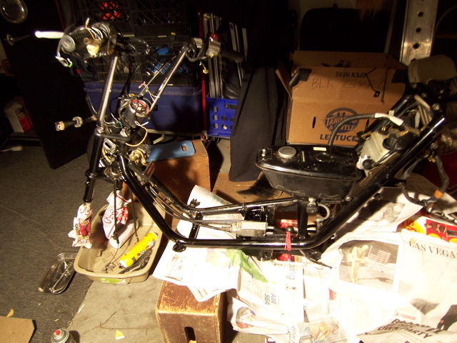

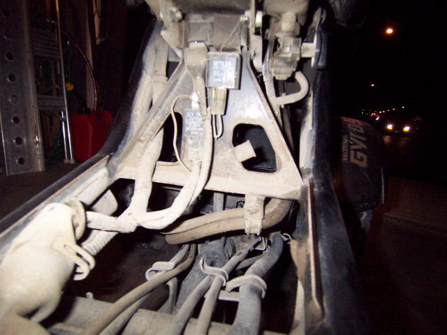

Re: 1985 BLACK HONDA GYRO cleaned /painted / running DONE!

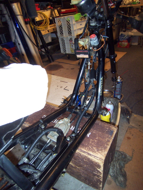

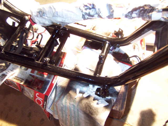

Painting the frame / the hard part was getting all the old dirt and rust off befor painting . I did remove most of the wireing harness . still not a fun job to paint . OK I was in a rush I havent got to the under carriage yet ...
- 100_9841.jpg (193.36 KiB) Viewed 10153 times
- 100_0031.jpg (178.21 KiB) Viewed 10152 times
- 100_0019.jpg (184.11 KiB) Viewed 10151 times
