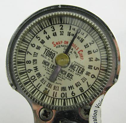

1/4" drive torque wrenches measure into the in/lbs and in/oz ranges. Conversion is as intuitive as it sounds - in/lbs is 12x ft/lbs. Wrench in the photo is set to 70 in/lbs - hair under 6ft/lbs.
-- smaller stuff --
I have a 1/4" 'nut driver' style wrench which measures 12in/lbs (1 ft/lb) full scale. It's way too small for scooters, - only good for approx 6-32 screws and below.

mousewheels wrote:== 'mustangwags' says it well, he got in during my slow typing. I'd second that a lower range (1/4" drive wrench) is a good idea ==
Use what you've got. If you are tool shopping, there are wrenches made for the low end.
My 3/8 wrench performs about as Wheelman describes. I use a 1/4 drive wrench for the 6-9 ft/lbs range.
-- smaller stuff --
Yo, not to hi-jack this thread, but ill bet that last tq wrench nut driver pictured is worth some money, ive only ever seen one of those, and juding buy the writing inside on the background, and the slight dis-coloration, i'd say that thing is OLD! lol ..or my monitor is dirty. hahaha

Can ya send me a full pic of that bad boy mr mouse? lol i'd love to see it!!

Sorry - a bit of the H/F topic, but shows there's a torque wrench for whatever the need.

Wow, calibrated even.
