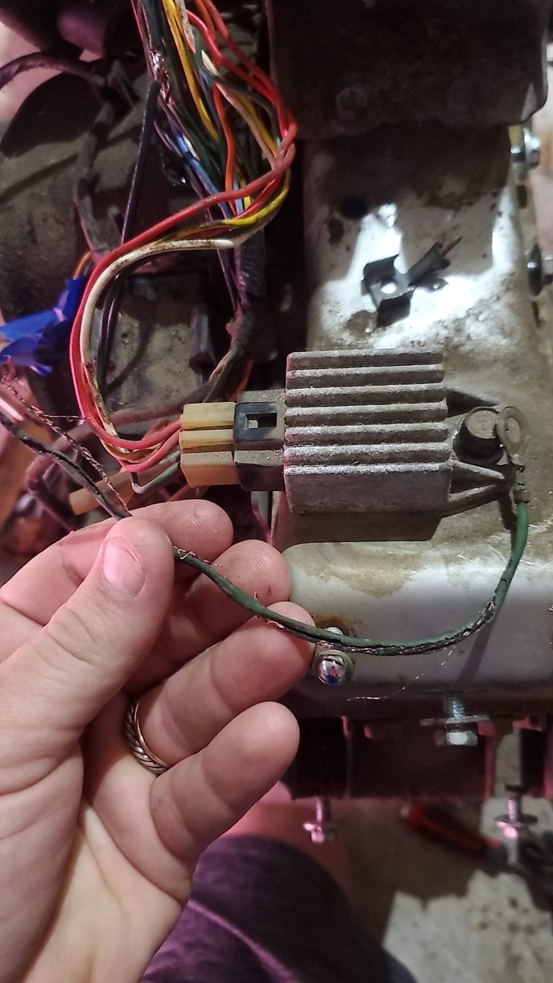

I know this is a old post So picked up a my 86 aero 50 was checking everything over before my tires come in and new petcock so I can run it !. I was looking at the regulator/ rectifier actually was only looking at it to maybe snag a spare and noticed the green ground cable that hooks up to it was melted by the back taillights had melted upon inspection I opened a good section of the harness up and it the ground had melted a good ways down where it stoppwd was about half way up from the floor pan . The rectifier was a bit corrided I cleaned off the base of it with some sand paper along with cleaned the top where the ground mounts & the frame section under where it mounts bit and the bolt whole .someone on another site suggested the stator could be bad BUT i thought if the stator is bad it would not allow the bike to have sprak .if i am not mistaken When the engine is turning over the flywheel +stator produce power that the CDI converts in the DC to send to the coil to cause spark at the spark plug . i know it has spark i checked that 1st before i found and removed the wire i posted i plan on using a DMM and printing the service manual to check the ohm readings when doing this from what I'm reading the bike has to be on and running. I'm going to go through and check all the grounds .
When you say you connected the green wire from the fuel sender to the frame . Did you do that off the harness itself? Or off the sender or both ? Bc 1 plugs into the other right ?
