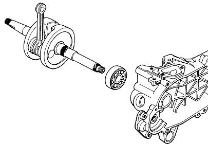

Finally, should there be any grease along the shaft that goes into the pump? It looks like there may have been at one point, I would assume the top portion gets lubricated from the 2 cycle oil itself but what about the end that goes into the block?
Re: Won't Start, Plugs Dying?
Posted: Thu Apr 21, 2011 11:09 pm
Oil up the gear, and slide it in. On the crank side, the oil pump shaft is inside the crankcase. It gets lubricated by the 2 cycle oil inside, along with the ball bearing on crank. You can see how the worm drive on the crank is inside the ball bearing below:
