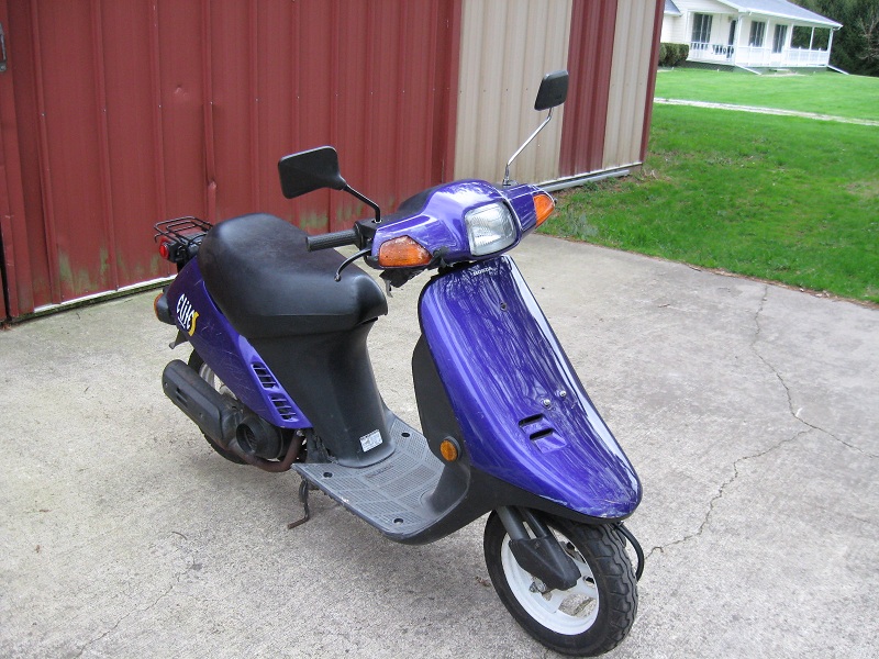

99 Elite S De-Restriction
Post by godfella691981 »
Hello, I was wondering does a 99 elite have the same restrictions as the other years? The only ones I know of are the plate that needs to be removed from the variator and then the muffler has the washer in the tip? Are those the only two restrictions on these?
<br>
<br>
:peace:
Re: 99 Elite S De-Restriction
The airbox inlet may be different - one of 2 holes blocked. Once deristricted, it is very important that you check your carb's main jet. Nothing smaller than 78 should be used at WOT. You may also wish to consider wiring the "throttle" lever on the oil pump so it runs wide open.
I had a 94 Elite S once before and I removed the variator restrictor, and I got right at 40mph out of it. And I never opened that oil pump and had it for well over a year..
My airbox didnt have any restrictions in it though, unless I was looking in the wrong place
Post by metric »
Got the same bike same color to the restriction is in VAR and pipe. I got mine doing close to 70mph on a slite hill with a polini 72 kit, polini gears, LeoVince hand made ZX pipe they dont make them anymore either, and stock carb running 110 race gas mixed
