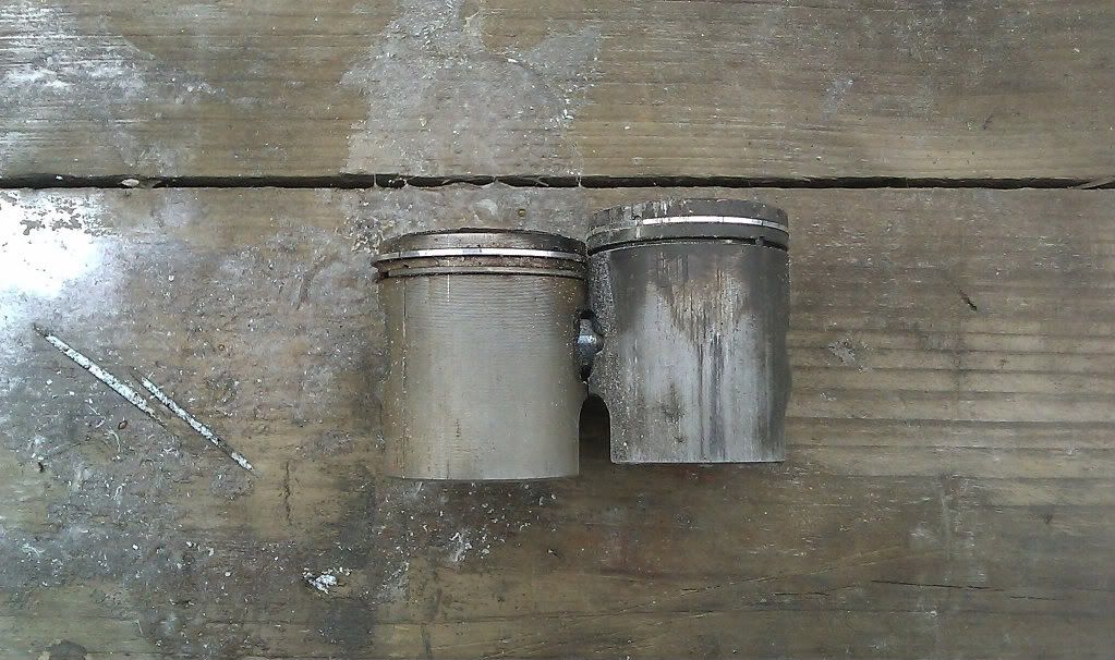

I have them both. The later model piston is considerably shorter. The pins seem to be the same size, but there would be little to no compression. I will post pictures later. I would have just bored my jug to 41mm. But that isn't happening.

All those use 10mm pins, I believe.
Other critical dimension is compression height, which is the distance from the center of the pin to the top face of the piston.
If you have two pistons with the same diameter, pin size, and compression height, they are for all intents and purposes interchangeable.

completely different :cry: Old chewed up one on the right(83-84) and late model on the left
