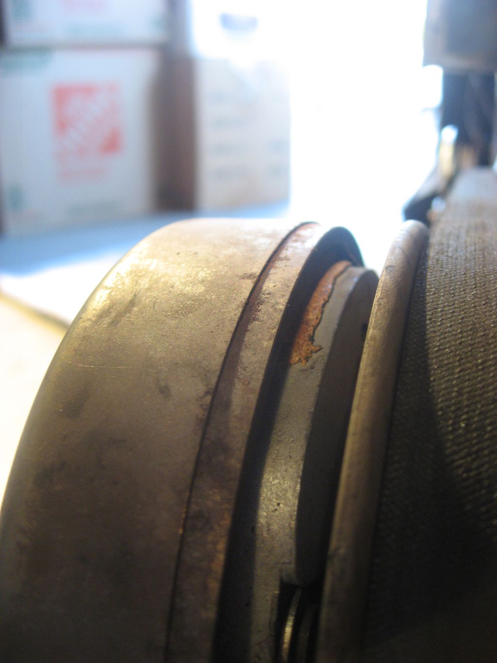

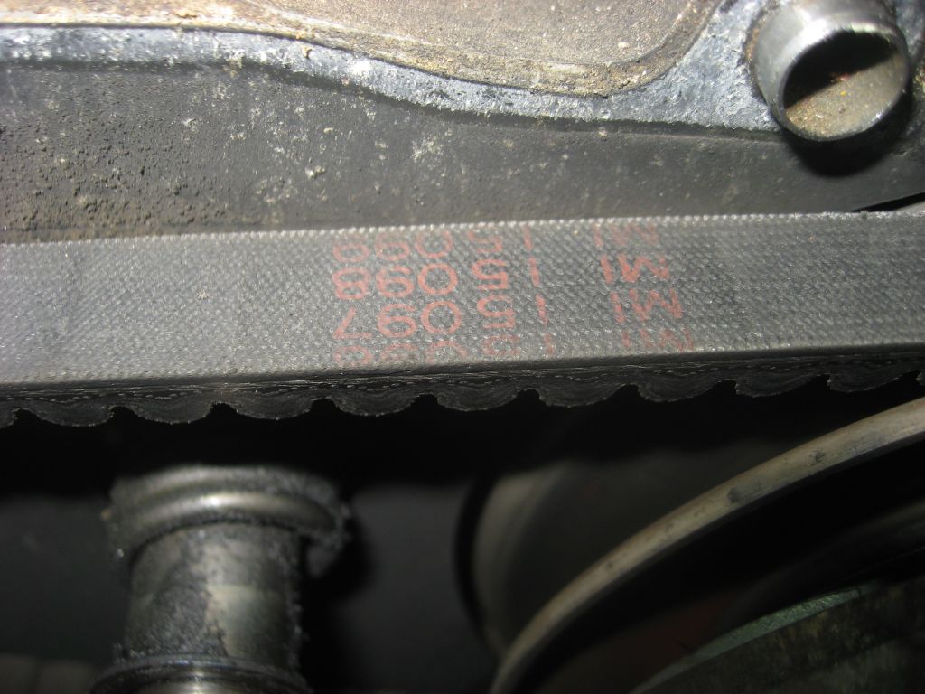

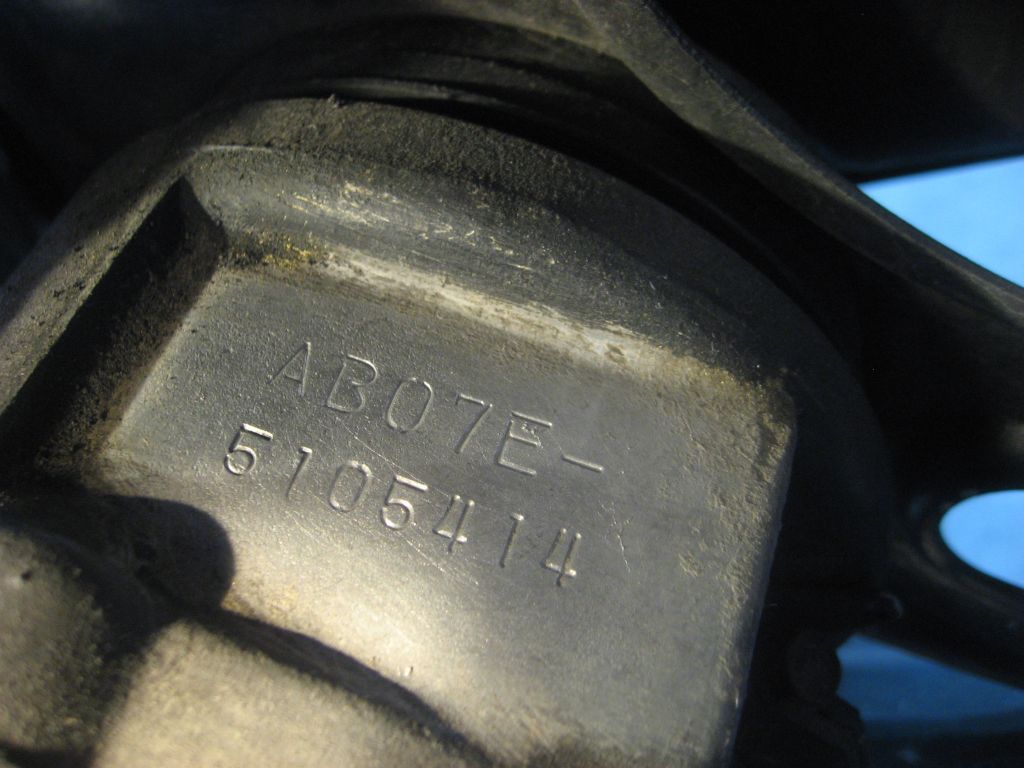

Here are some pics of my transmission parts, and engine code. Looks like my belt isn't riding all the way up the variator. Is it safe to call this "room for improvement" in regard to top speed?

You can see from the last pic that the clutch pads are just about gone.
- IMG_3462.jpg (133.84 KiB) Viewed 25402 times
- IMG_3457.jpg (102.81 KiB) Viewed 25402 times

Re: 1984 Aero 50 Compatibility
Did you measure the belt? It looks worn and if it is at or below minimum width, the belt will not ride all the way out on the variator.

No, didn't measure it. It is still in relatively good condition, but who knows when/if that belt was last changed. That will be #1 on my new parts ordering list.Did you measure the belt? It looks worn and if it is at or below minimum width, the belt will not ride all the way out on the variator.
