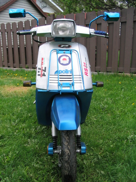

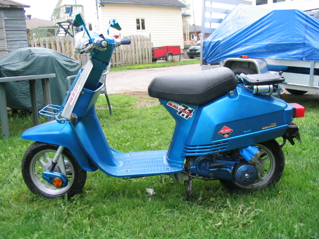

aero 1984 almost finish

Re: aero 1984 almost finish
this is other pics

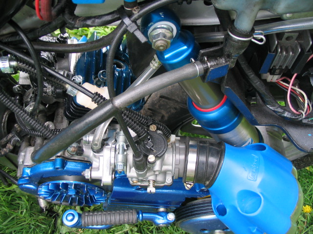

ask the seller at http://www.50cc.eu or wait for a bbk that i will receive tomorow or aftertomorrow i buy 2 kit so iwill have an extra one the seller told me that fit but if not i will get the 2 cylinder to a machinist for fitting! and the price is $120 a good price i think. so if interest let me know.
for the variator same thing i take the nb50 85 malossi and i cut the pulley boss at a machinist for $20 and that fit well and also i buy the zuma front pulley and that fit with the right washer that you insert in the front where the bolt is. sorry but if you want to know everything let me know what and i will post pics of how to do that!

also nb50 me is call melody in europe and its not nb50 its nd50 and that its just for ab07e engine.
