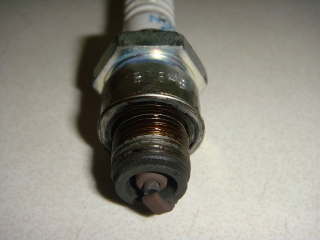

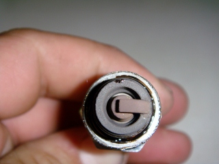

gauge reads about 210 spikes to about 260 at stop lights...Trafficjamz wrote:what does your oil gauge read when these problems occur?![]()
What does your plug look like?
Does this problem not happen if you go wot or just part throttle?
plug looks pretty good not perfect yet, still playing with jetting and tunning....
problem its has happened 4 times now 2 different accurances... around 35-40ish mph cruising so part throttle.. never happens when im WOT or even 3/4.... just runs around that speed...

Re: 28mm oko running out of gas????
if your running a 48 pilot in a 28mm carb, its running lean down low so that will include your 1/2 throttle area. you should be running at least a 52 pilot if not 55. being that your make shift cht gauge is not quick enough, Im bet its not accurate either because 220 is pretty much a idle temp for thses engines. dont let the color of the plug fool you either. if your not doing a correct plug chop. you will never know how it really running. it can turn that color in a few seconds at idle if the plug is hot.
