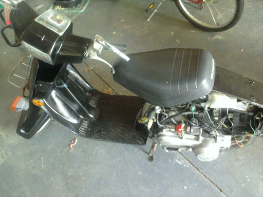

Thanks to everyone for suggestions on the bystarter. If you haven't been following before, I will recap what as happened.
I purchased an 83 Aero 50 for $275 from a 'bubba'. (I use the term bubba as one who repairs repairs machines with what ever is available. Case in point is the bubba that previously owned my old 944, who tapped, then cross-threaded a machine screw on to the rotor. ) The bubba who I bought the Aero from appeared to try to pull the bystarter off with a pair of pliers and succeeded. After discovering what he did, he put it back on using a hose clamp and a piece of shop clother. Similarly, he discarded the airbox and filter, and replace it with a shop cloth and hoseclamp. Additionally, the front brake plate was broken on the ferrule the cable goes through, so bubba wired it inplace with zipties and wire.
Spree turned me onto a couple of ebay auctions, and I have since obtained a clamp on air filter, and have ordered a replacement carb. The carb is made for an 86 Aero, in that the bystarter is on the inside rather than outside. When asked about the compatiblity, the seller indicated that the bystarter will be in the way of the shock absorber; Spree has proven that to be untrue.
I have removed most of the bubbazation and receiving the air filter, have taken the Aero for a test run. The top speed is 25 mph. The compression tests out at 75 PSI.

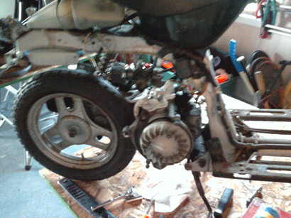

The boy and I have taken the Aero down somewhat. All plastic is off, removed the front wheel and replaced the brakes. Back Brakes look fine, but the wheel is somewhat out of round. All it will be getting is a new coat of paint unless anyone can lead me to a cheap rear wheel.
We took apart the head and saw where the head was leaking slightly, and the bottom ring was seized. Taking rings of and measuring them, they were well within spec. Will probably, just clean out and decarbon the piston and replace. The cylinger was still fairly scored, so we can probably skip the hone.

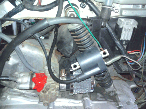

I discovered why the ignition coil was wired onto the side. The original coil was still installed without the spark plug cable, and the second coil and wire were too short to reach. Aparently Bubba cannibalized another scooter for the coil. Oh, Bubba when will I stop finding your 'modifications'? The drywall screw holding the handlebar cover together was 'un'genius.
One slight error occurred when taking the side cover off -- the kickstarter spindle came out enough to twist and tear the gasket. Now I have to take of the pulley and belt, and replace the gasket. The belt is 13 mm wide, slightly more than the service spec. Any comments on what original was? Also, is there anything in the drive train that if worn might have contributed to the slow top speed I was originally seeing? Anything that as a rule should be replaced now that it is open, and will add back to the top speed?
