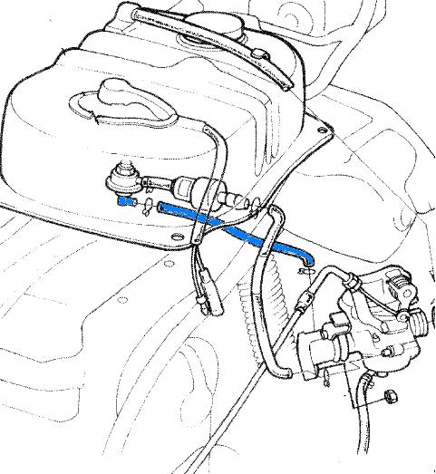

I have no idea where the vacuum for the petcock goes and the manual is NO help.
This diagram puts the petcock vacuum line's approximate location on the other side of the carb from the airbox.

The IPB clearly shows the nipple.
Sure does - good one Bear.

http://www.hondabike.com/fiche_section_ ... &fveh=3087
This shows the difference between my 1985 CH 80 and the 1996 in your link.....not sure which one the phantom owns.....point of interest to consider.....either way, phantom has found the vacuum tap.....he'll be back soon, no doubt......... :urban:
