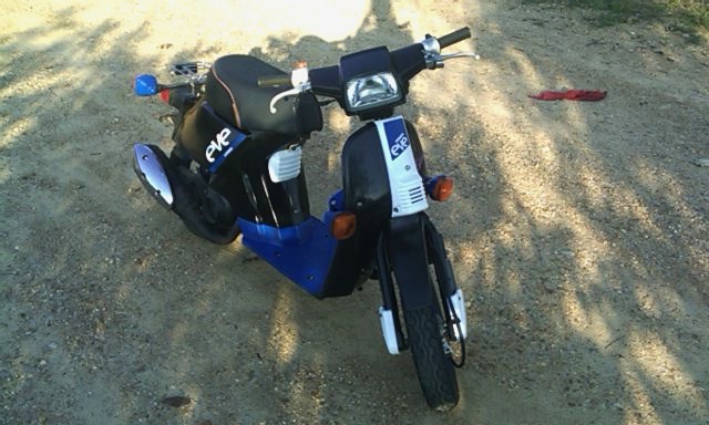

Since I figured out my variator rollers were stuck keeping me in high gear she is running good, only took her for a 3 mile ride to check the jetting. still a little rich on the top and lean on the bottom but have jets coming in the mail to tune with. clip is one up from the middle with a 42 pilot and 95 main and hte mixture on the plug chop was a glossy brown so i think it is still a little rich somewhere since it runs best at about 3/4th turns out on the air mixture. since i have her almost running perfect i decided I needed to reinforce my weld on the elite front fork swap. used a drill press to drill 1/4in holes, one on both sides of the weld then stuck the same size bolts in the holes, dremeled then off and hammered the remainder flat on both sides to hold the pins

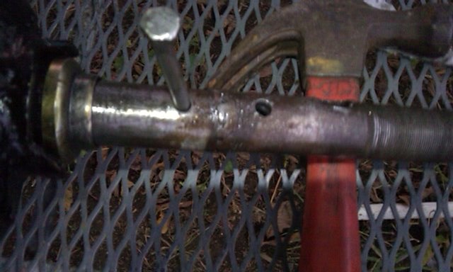

also tightened my steering nut really good this time so no more front end wobble lol I wanted to make absolutely certain that my front end was not going to break and fall out from under me, never can be too safe. Can't wait to go for a spin tomorrow may go visit this chic I have been flirting with that works at the gas station, she likes me to show off my rides lol and gets mad when I buy gas across the street
--I should mention I have a steel pipe welded inside the fork pipe otherwise pins wouldnt hold it if it breaks
