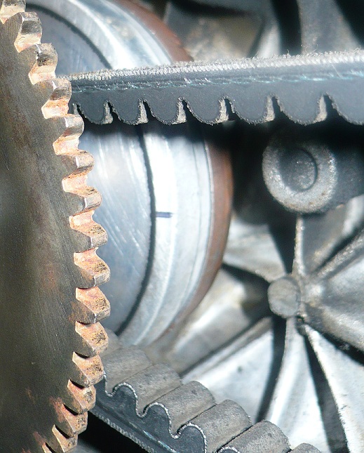

So I've been riding around on my SE50 swapped spree and I am getting about 35 on the speedo with a 2.75 tire. When I put the variator on I marked it with a sharpie to tell how high the belt goes, today I opened up the cover and it seems like there is a little more to be had, I'm not sure though.
What do you seasoned variator tuners think?

That looks about right. Is that a stock variator?

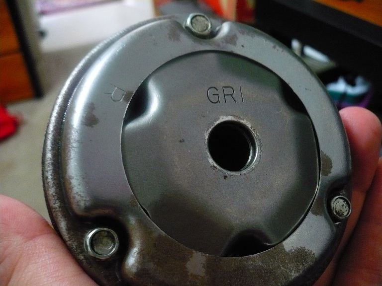

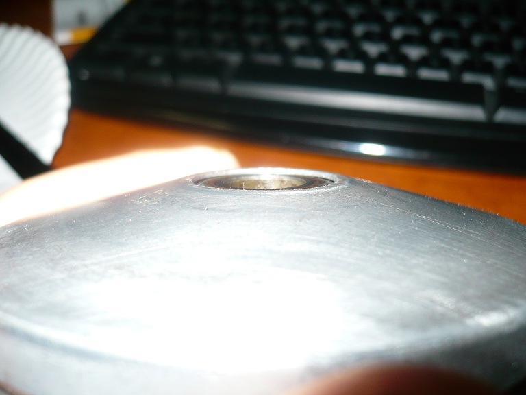

How does taking the back plate off help with this? I see this posted pretty much any time someone talks about a variator. Before I installed it I tried to determine why people say to do this but could not. Take a look at these pictures to understand my reasoning....
This is the furthest the ramp plate can possibly push the variator with the back plate on
We can see at that amount of "extension" (I don't think the rollers can even push it that far) that the variator is further than the slide, which it cannot be because of the drive pulley. I see no way that taking off the plate can increase variator travel. Maybe it is different on the AF16 than on the AF05E?
I might be missing something though.
Re: How high should the belt ride on the variator?
ChrisH821 wrote: Maybe it is different on the AF16 than on the AF05E?
Yeah the length of the drive boss is different.
