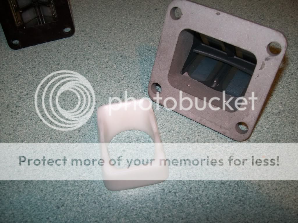

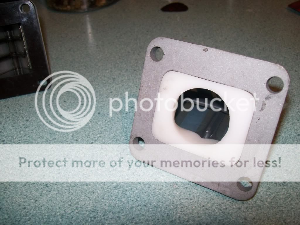

Did your big black reed cage come with a white plastic insert?ottoman wrote: If Traffic sends me his V force reeds I will test those and the larger adapter.. now that we have some base numbers
I think it is there to increase air velocity.
I will send both inserts for the big reeds

This is the insert that I was talking about. What is it's purpose?
I have one of these for my Vforce reed block too
