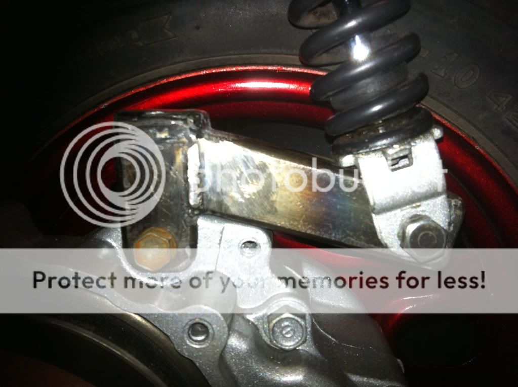

I like your shock mount fabrication. Did everything else bolt on nicely or did you have to fab the engine mount?
Also, what size are your tires that you have on it?

Evilone thanks for making it easy to view the pics solid I'm new to this but I'll get the hang of it.@ Carnie thanks I like it to it worked out fine the motor mount I just stretched it 6 inches everything lined up fine. The tire size is 3.00-10 Front an back I tried a 3.50-10 for the back but it looked like it was going to rubb the block so didn't do it.SHAKAS....

Much respect for the ingenuity and skilled fabrication demonstrated in the shock mount. I do have a concern about the mechanics of transforming the shock mount hole from a "Push" to a "Pull" function. High leverage forces will be applied to the top of the bolt hole, and through that leverage there is a chance for the segment to fracture and break the bolt out of its hole. Maybe this has been done before, but I urge caution.
