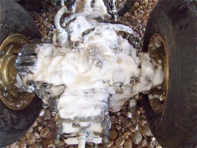

Sounds good Photos would be great .
On this 42mph was that downhill ?
Kidding 42 on a gyro good work all you need is squeeze another 3 mph and your done .
I tried to use liquid laundry detergent instead of gas .
