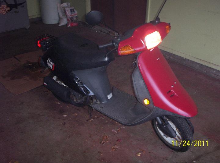

My project for the winter. Can't wait for the spring :geekdance:
