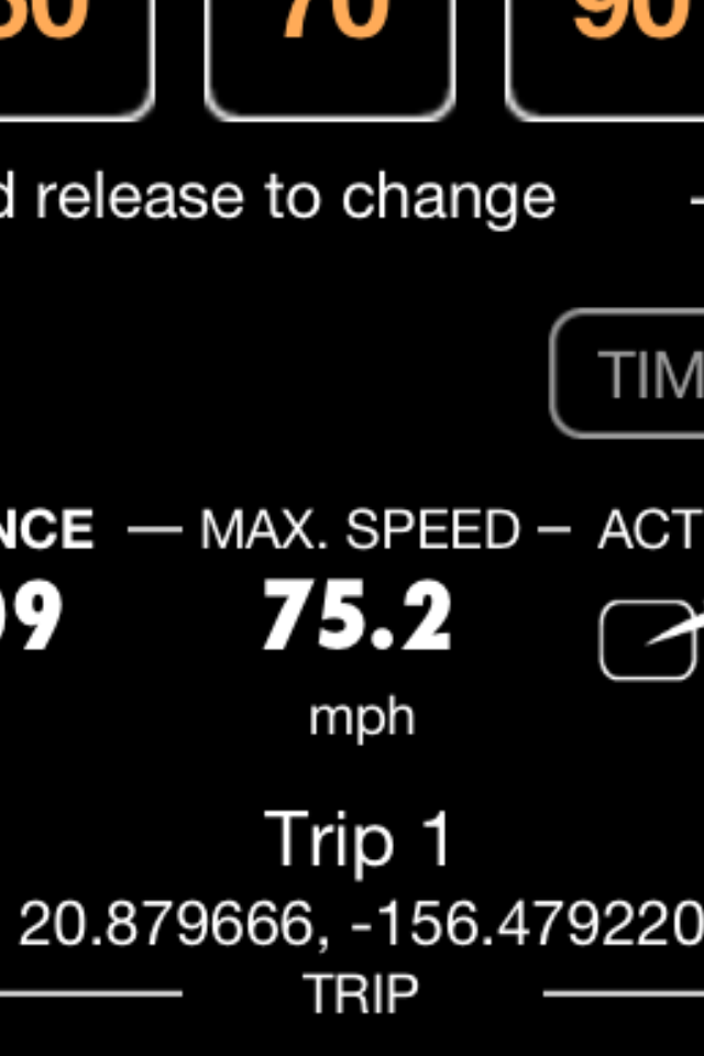

thankz taz i change the drive face with another one i think i had s on, changed the weights to 9 grams and change my clutch.. now hitting 75MPH i think it wants to go faster tho.

That's scarey fast :-)

how can i make it go 80+?..
