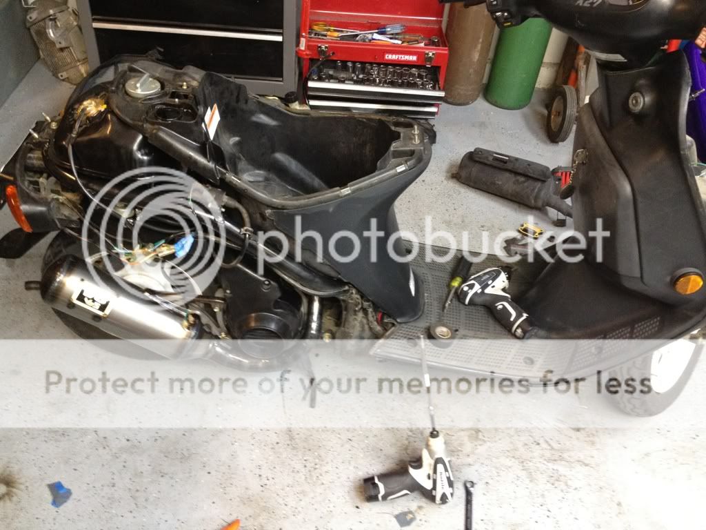

So here is my build:
50mm Tai BBk
26mm OKO Carb
V-8 pipe
Mixed gas 28-1 for break in
I want to keep this on topic if I can manage so I can have a decent beginners reference. I just put the basics on tonight it took about 4 hours, half that time was figuring out how to remove the elite plastics with out damage. Enjoy thanks for all the forum members who helped me select parts.

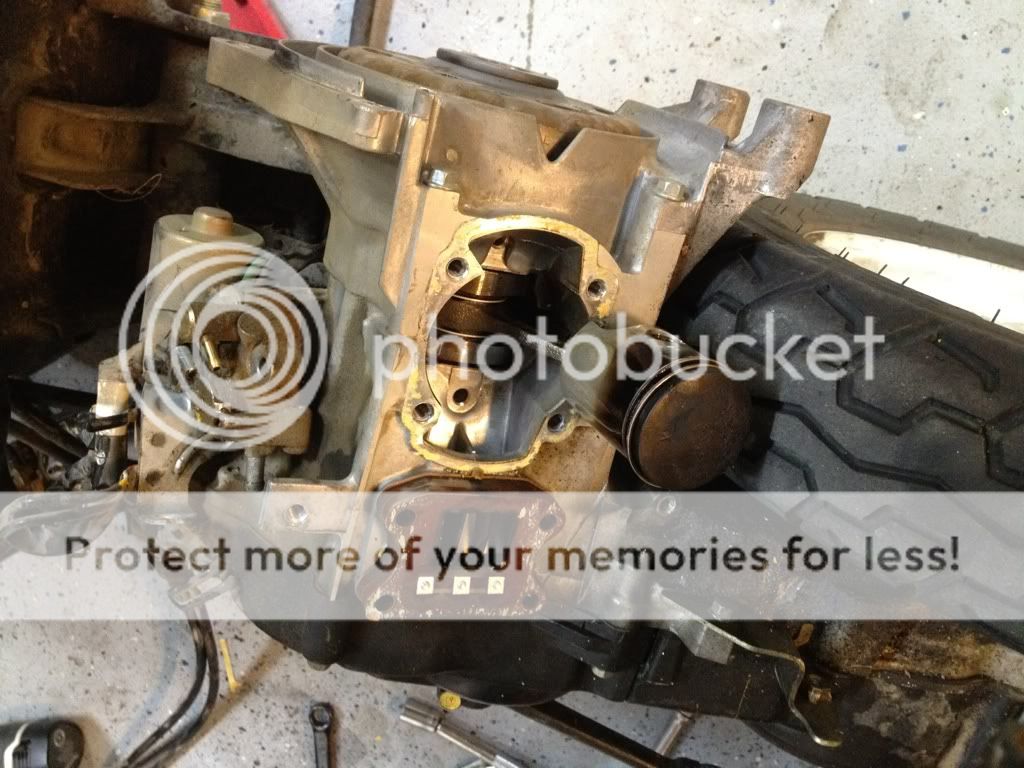

At some point you may want to go back and match the boost port, if i am not mistaken the 50mm kit has a larger boost port for the dio motors opposed to the small elite port. Personally with that kit since its better to match the boost I would pop in at least a ministroke crank while i was in there :D ON the other hand I believe there are several people on here that have run this kit without matching the boost without any problems

MAKITA rock man, I love em too. I bought them just for this project, and future ones. I did not match the port for now, I would like to make corrections as I go and note the changes. This should be a indepth build. Once I have a tach I think it will be interesting to see what rpm increase a boost port match will do. Once I got my kit, and saw what all the noise was about witht the boost port I decided it did not look as if it would impare the engine much to leave it. It is not like the air is hitting a wall which would happen if you put a af16 jug on a af18 case. So time will tell, I msy be going against the grain a bit. But thats how I roll, curiosity never killed this cat. It may have ruined a few projects though. :hi:

You can get away with not porting the boost port on the case if you were going to run the stock exhaust. But if your going to run that v8 pipe, the boost port will need to be matched.if not the cylinder will run hot and possible seize. The boost port helps with pushing the used air/fuel out the exhaust.
