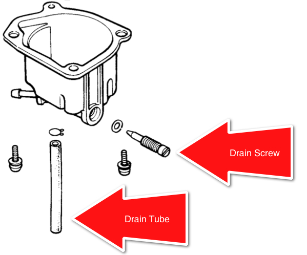

You need to check if your float bowl is filling up with gas. See attached photo. When you put your carb back on, hopefully you installed a drain tube. Put a pan under your Spree and open the drain screw a few turns. If there is no gas in the bowl, that's your problem. Since the petcock is vacuum-actuated, it sometimes takes a minute or so of cranking the engine to get the float bowl filled up. You can also pull the vacuum line off of the intake manifold and suck on it to manually deliver fuel to the carburetor.
- Drain Screw.jpg (97.51 KiB) Viewed 8286 times

Okay timmy i do have a drain hose on it i went out and opened the drain screw and only a few drops came out i pulled the suction tube of the engine and sucked on it but the carb bowl never filled up but when i pull the gas hose off the carb gas pours out of the tube... its just not getting into the bowl...TimmyC wrote:You need to check if your float bowl is filling up with gas. See attached photo. When you put your carb back on, hopefully you installed a drain tube. Put a pan under your Spree and open the drain * a few turns. If there is no gas in the bowl, that's your problem. Since the petcock is vacuum-actuated, it sometimes takes a minute or so of cranking the engine to get the float bowl filled up. You can also pull the vacuum line off of the intake manifold and suck on it to manually deliver fuel to the carburetor.
