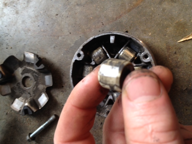

So far I love it. Pulled the variator off today to check out the rollers, two of them were sideways and out of place, holding the ramp plate open. Fixed that and now it cruises easy at 45. Got to 53ish on GPS on flat ground. Its a dog going up big hills though.
