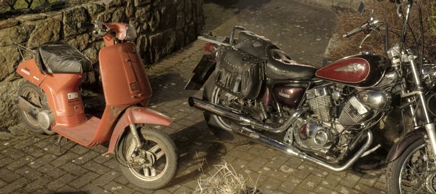

I bought an ND50 in running but horribly abused condition (bless them, they never quit) and I'm in way over my head. I've got a history of mechanics, but only with big stuff that has four wheels, rollcages, and a turbocharger crammed into every available space. A little scooter is a totally new thing for me.
The idea is that I'm going to strip it all back, de-rust, fix everything that's broken, upgrade what I can, put it all back together, and then give it away to someone who needs it more than I do. So far, I've done one of those things. Then I took a step back, saw the extent of my spanner-happy idiocy, and decided I needed some help.
Here it is the day I brought it back, alongside my current daily.
It doesn't look like that any more...
