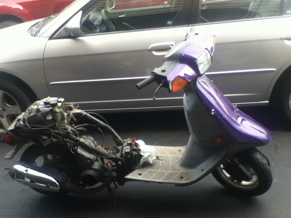

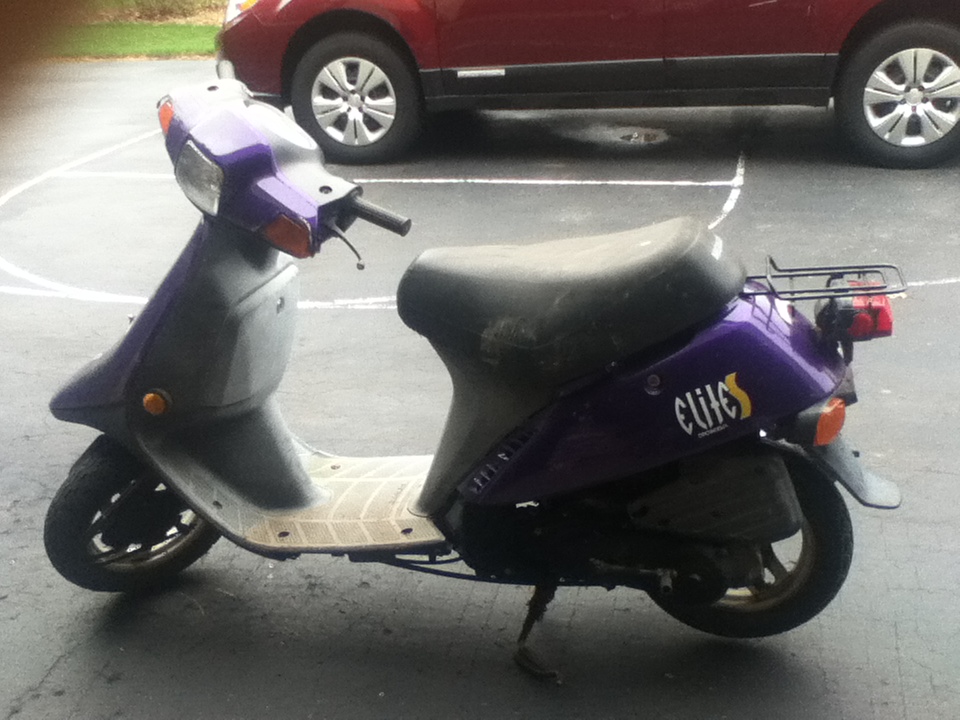

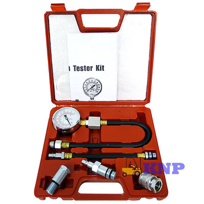

Suup all need some advice. I have a friend that have had a Honda elite that has stop working a year an half ago. Now it is sitting in my garage. I have clean the carb ,change the air filter ,change the spark blug , i dump the old gas and old oil out . I've bought a new battery and change the fuse. I have tried to electric start it but not even a sign that says it will electric starts. So I tried the kick start . Nothing happen . Then I choke it with my hand it start but went dead again . I know it is not my carb because I clean it over and over . Every times I take the air filter out and choke it with my hand then put back the air filter box then kick start . It start for at least 15 second and died again. I am about to buy a compression tester to run a test. Question does it required a specific compression test ? Because I stop at auto parts today the cheapest one I saw was for $20.00.
Other questions
When I unscrew the fours screws on the top of the cylinder there is one part that seems it is glue and I can't reach the piston to look at it . How do I get the Piston out????????
When I finish running a compression test and change rings if needed would that result the fact that it can't electric start???????? :peace:

I just order a compression test kit hope it will worked .

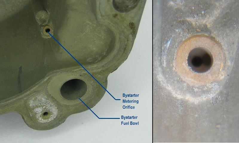

Is it the bystarter because I also have a honda spree and and if I kick start it . It will start with out the bystater on the carb.
Re: Need a quick help For my friends Honda Elite .
I suspect the pilot jet is still dirty......go clean it again. :smile:

you might need to soak the carb in a carb cleaning solution. spraying it with carb cleaner doesn't always get the very small pilot hole cleaned out. or view this topic viewtopic.php?f=3&t=22645 if you know someone with the cleaner.

I will try to clean it again but I had cleaned it like five times all ready with guitar string

yes all of them except for the tiny one inside the bowls that hold the gas
ragtop89
Posts: 281
Location: STL
Post by ragtop89 »
That's your pilot jet hole.

I just put a picture up. Do you see where it says bystarter metering orifice . That is the only one i can't get a guitar string through .
