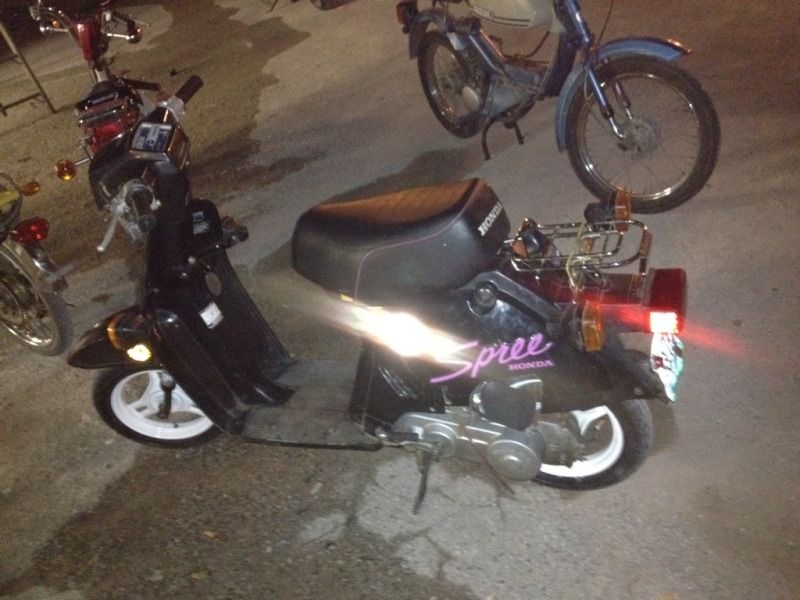

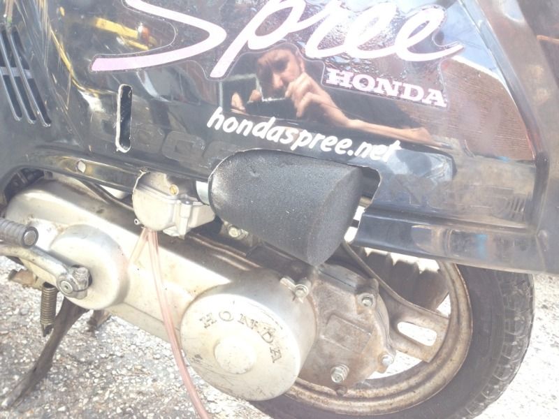

Got my plastics trimmed. Made a slot to work the choke with a pocket screwdriver

paulpauly7

so how hard does that trim push on your filter when you ride?

paulpauly7 wrote:so how hard does that trim push on your filter when you ride?
Pretty hard apparently. We figured that shortly after the pic was taken
Swimming, that's what buffed panel looks like

Wow i cant believe you hacked up that panel

kingkamehameha wrote:Wow i cant believe you hacked up that panel
Didn't have a choice. We tried to keep it as clean-looking as possible. People really seem to dig it. Besides, it's not like these bikes are rare.
