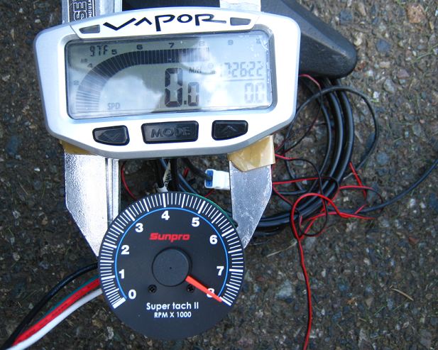

Automotive tach installed on AF16. Comparison run with Trail Tech Vapor. Tach readings track between the to meters.

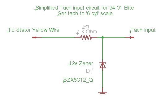

Edit: There is a simplified circuit which follows (mousewheels, 05/02/2012)
Breadboard:
Not much to wiring up this board. Breadboard has a component substitution for D1 - seen as a second transistor.
Schematic: -- Update: Another approach --
Original driver board was meant to present a low load to the input signal. The spark trigger pulse coil has less output than the stator. Also, it has an output strictly between +12v and ground. Allowing a greater input load, and that the tach input signal can go to about -0.6v, lets us use 2 components and no perf board.
Notes: (05/02/2012)
The Sun tach in this thread has an internal diode which blocks any negative voltage at the input. The -0.6v neg limit of
this circuit is not seen by the chip in the tach.
This circuit is an example, it will be built and tested this week.
Breadboard:
Notes: (05/02/2012)

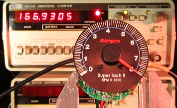

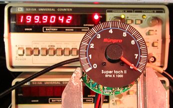

Rescaling Tachometer Ranges -- 8k --> 10k/12k/15k
Results are about dead on accurate.
Calculated resistances for various modified full scale tach ranges: The calculated values were mapped to standard commercially available 1% tolerance resistance values. For location of the resistor being changed, take a look at the photo on the first posting of this thread. It is the vertical resistor with the yellow 'fly lead' attached.
Results for 10k/12k/15k rescale of the Sun tach to 1 spark/rev operation. For the photos below, the reader needs to 'imagine' mouse created new artwork for the tach scales for the proper max range. For now, the pointer sitting dead on 8k means the re-scale was successful. You may compare the Calibration Frequency shown above with the HP Frequency counter showing the input frequency required for full scale operation. Results are pretty much dead on.
10k RPM calibration (theoretical full scale at 166.7hz) - 627 kOhms (measured)
Result: Passed, in calibration 12k RPM calibration (theoretical full scale at 200 hz) - 531 kOhms (measured)
Result: Passed, in calibration 15k RPM calibration (theoretical full scale at 250 hz) - 422 kOhms (measured)
