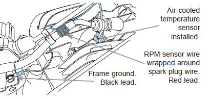

anyone know how to hook up the rpm sensor on this gauge? just got mine in today and hooking things up as i type.
Re: trail tech vapor
The TT tach pickup is 2 wires. Red wire - few wraps around the coil wire. The black ties to ground.

Your going to need to extend that pickup wire. You can use speaker wire for that. After you wrap the wire around the plug wire, use electrical tape to hold the wire in place. Then your good to go. Had mine like that for almost 4yrs now.

You could also try reading the detailed instructions. I think it says 5 wraps is all you need on the coil wire. Too many messes up the reading. It is adjustable but I remember 5 wraps.

thanks for the info didnt want to believe the instructions cause it looked odd to just wrap the coil with wire and i rather have input from people that have this kit on their bikes. now the last thing, could someone tell me the settings to put into the gauge so i can have the most accurate reading possible, my tire is a 3.00x10 irc on a elite s rim. if not i guess ill try to enter it in as best i can. ill have pictures up when completed.
