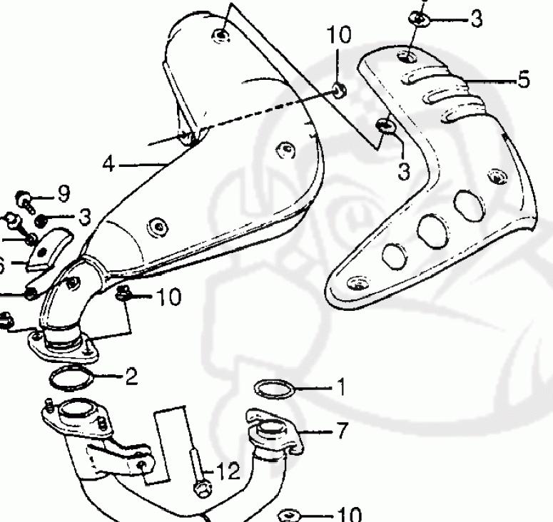

I have a honda gyro TG50 3 wheeler. its SO SLOOOW I know my muffler is plugged up and it is very restrictive.
I have been toying with the idea of using a Leo vince ZX or a CPI stock 50cc muffler. I would mate the pipe where the stock muffler meets the header pipe, make a fancy bracket and look at minor airbox mod and up jet or carb swap.
gyro muffler.JPG (75.17 KiB) Viewed 1741 times

The gyro is slow for a reason. It has a two speed as you know. Because of this, the transmission can only go so fast. The fasted i have seen one go is 38, and thayt was with porting and a bigbore kit. If you do a tuned muffler. You will have to get a new carb and mess around with the oil pump and get a new air filter. Its a time consuming process. Trust me, i have ten gyro's. Its not impossible. It just takes alot of time
