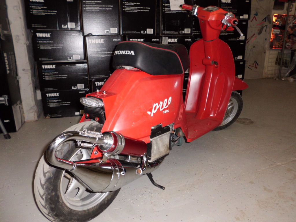

hello.
Tabs808..thanks fer the info,I have nothing to loose by trying it. I used the chopped off stock pipe to weld this up. the flanges were close on the pipe, but I found this to be the cleanest solution.
fastplastic.....what up dood?, this build is a hard tail, the frame is strong..more bracing than you can see in the pics. check out all of the metros with gy6 swaps alot of them are hardtails. and they are pushing some 2 stroke torque and speed.(if any extra bracing is needed it will go in) thanks for the comment tho. (if you disargee, let me know why..thanks)
fishman43... with the amount of beer I drink, a kidney belt is a good Idea for this build. the seat has so much foam I think it will be fine,, gotta watch for big potholes!! pipe side pic comin up.

Post by spazz »
so here is how she sits now..the rad cover will be ordered from jdm password. I have already ordered my axle spools and kickstart in red..password jdm is awesome.
