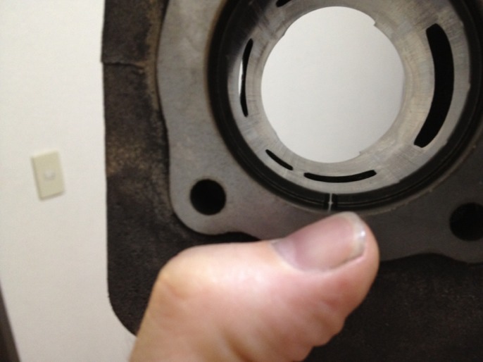

Madman
Posts: 261
Location: Japan
50mm taiwan bore info
Post by Madman »
How about this?

Mystic
Posts: 2140
Location: Guys, Tennessee
Re: 50mm taiwan bore info
Post by Mystic »
wow that is definately not true round, possible reason for seizure??

is that the piston ring?
Madman
Posts: 261
Location: Japan
Post by Madman »
damnSA50 wrote:is that the piston ring?
yes it's the piston ring. The gap is the main point! The cylinder is round it just looks distorted in the photo!

Fishman43
Posts: 728
Location: Durham, NH
Post by Fishman43 »
Madman wrote:yes it's the piston ring. The gap is the main point!
Do you have a set of feeler gauges to check the gap? It is really hard to get a sense of the small differences (tens to hundredths) by eye.
bakaracer
Posts: 3519
Location: tacoma,wa
Post by bakaracer »
You have to check with a feeler gauge to make sure what the gap is at. But just by looking from your pic ,that looks like its more than enough. My guess is .013
