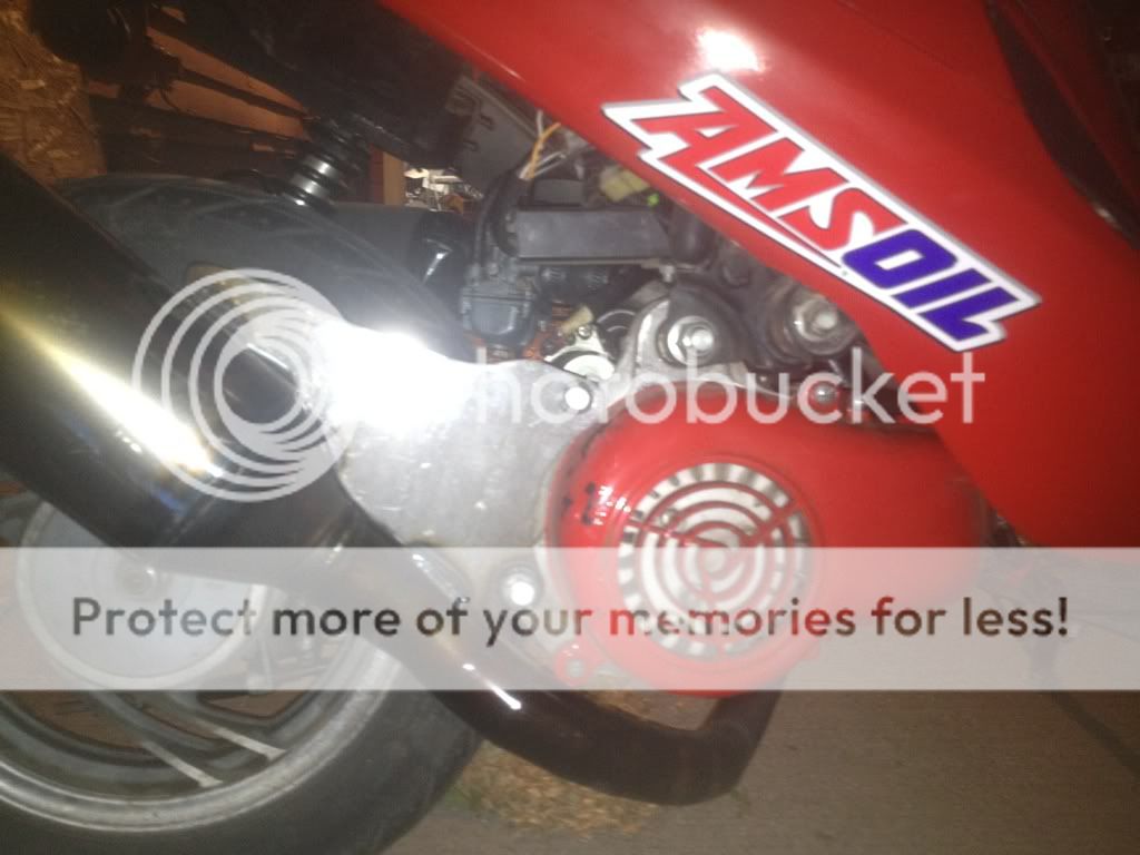

Re: Big Bore Kit Jet Size- Gy6 Chinese Dio Looking body
Do you have a picture? Sounds like a minarelli or morini.
I will try to get some later, it is not at my house. Thanks for the help. He is pretty down, he was hoping this thing would be like my elite, and it feels more like my old spree.eliteguy50 wrote:Do you have a picture? Sounds like a minarelli or morini.
That is a minarelli engine.
Re: Re: Big Bore Kit Jet Size- Gy6 Chinese Dio Looking body
Hmm. Im gonna tell him to order a new piston kit. I will rehone it and try this again from scratch. He seized this thing like 13 times. I tried to get him to build it at my house somebody need to learn the hard way.graphite9 wrote:Which means it should be running way harder than a af16eliteguy50 wrote:That is a minarelli engine.
