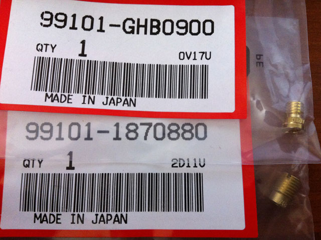

Using the jet reference in Wikispreedia, I ordered a 99101-GHB-0900 for my Aero 50 and found that the jets that they send have the smaller thread than the 99101-187 jets.
Be aware of this if you plan to order jets based off the jet reference page.

yes the ghb type jet looks like a mushroom(i believe). i think i posted pics of this before, i ordered the ghb for my elite and got those type even though it says alternate part#.

Thanks - I've pulled GHB jets from the 'wiki.
