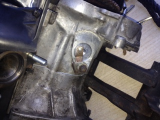

finally done with the block.LMK what you guys think.

Clean! What are those marks on the oil pump plug?

its like that

People dimple the oil plug to try to keep it in place. If i was you put/make a bracket to hold it in. Nothing worse than it popping out or starts leaking air.. kaboom!

There was a thread about making a bracket for a oil plug and I followed it! But it cost a few yen!!!

nice motor dude...is that the corsa? this is how i did my plug

Nice engine, but I agree with them all. Do something about that plug or it will come off when you dont expect it and it will be devastating. Also bring your stock fan around with you as those fans like to explode.
