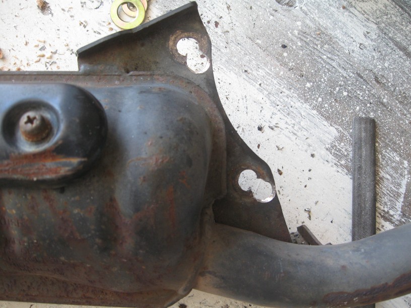

I did have to slot my stock exhaust's mounting holes to work with the BBK. If I had drilled perfectly, then new holes would have been all that was required.
I first attached the pipe to the cylinder and decided on the ideal position, then marked with a punch what I guessed to be the center of the threaded holes in the engine, drilled with a 3/8" drill bit, filed as necessary to slot and bolted on with two washers, one about the same size as the bolts and another larger one to spread the load as well as cover the slots.

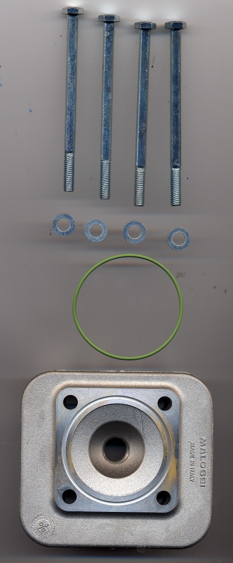

Malossi BBK cylinder head parts: cylinder head, O-ring, bolts, washers.
- malossi bbk head parts edit 2.jpg (108.98 KiB) Viewed 15998 times
