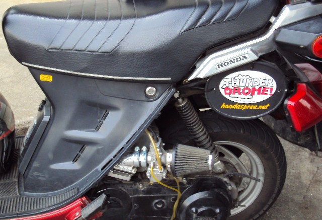

Fantabulous score !!!!...next thing you will want to do is something like this
Ridgetop ride 003.JPG (105.62 KiB) Viewed 7736 times
