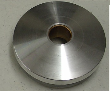

this then?

Re: 84 aero 50 help
That'd be the variator casting, or "Drive Face" in Honda-speak. A spectacularly clean and unworn one, too. The '84 transmission is a bit of an Odd Duck, to the majority of us who own AF05 and later engines. I'm not certain if/how you can adapt the performance variators designed for the later engines into yours, but it's worth exploring.

Wheelman-111 wrote:Greetings:
Last I read, a custom boss was needed.
