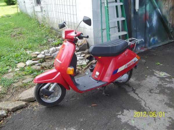

Hey guys,
First wanted to say hello and what an awesome community here. Coming from mopeds, it's alittle out of the norm to see 4t and 2t enthusiasts sharing the same forum and uniting under one common love; Honda scoots.
I've been looking for some mopeds lately on craigslist, and stumbled upon a "moped" for sale:
Made sure it had title, it has 3000 miles on it, guy told me he bought it from an old man who took good care of it. He said he bought it and cleaned the carb last winter and it sat. He started it and it idled for about a minute then died. If i gave it gas it would lean out and die. Something in me thinks either 1. the carb jet is clogged, or 2. the petcock is frozen or clogged and gas isn't getting to the bowl fast enough. Either way the bike also was missing a front brake cable that the man tried to find another one but said honda couldn't get him the part. I understand that these honda oem parts are no longer supported. So anyone know if an elite 150 cable will fit? the man told me it was 36in in length but I don't know who to trust....
I found this site that supposedly carries the cable but the part number is discontinued and replaced with a different part number which is in stock:
http://www.cheapcycleparts.com/model_ye ... s-switches
So the bike starts but dies upon giving it throttle, as a moped rider I have cleaned and fixed a ton of carbs in my life and know that this is most-likely a carb issue. First thing I am going to do is take off the carb and disassemble and clean it thoroughly. Identify what size jets are used and post back here. I will also clean out the air filter while i am down here and check the oil feed from the intake manifold.
Do i need to crimp the gas line or is the petcock auto shutoff when the bike is off?
I can't wait to ride this scooter, it is my first scooter, and I love ST:TNG themed stuff. This bike is right out of the next generation 1980's futuristic feel. Like the enterprise only a little slower.

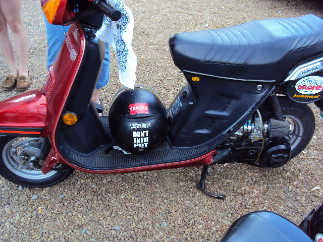

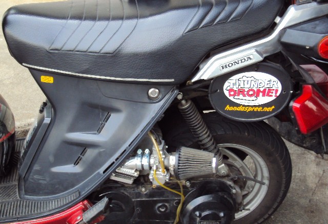

mikeosoft wrote:Motormike, nice to meet you! Are you the dude with the custom 4 reed intake setup? If so I'd like to know more about it.
With an adapter that I got from Bear, and a CT manifold fom tazland001, I used a 24 mm Mikuni flat-slide with 145 main. You loose the inner fender which is integral with the airbox. Those being the only mods and with the original belt, the difference over the 18mm carb is considerable...about 5 mph topend, but getting there takes place much quicker. It would really come alive with a pipe now...there is still some left in this curent set-up...BTW, my speedometer is noticeably slow, 5 mph at least, and I can see 58 on my best WOT runs of 1 mile. I'm saying it is probably doing 63 mph. No GPS...Bear is right about those numbers... :werd:
