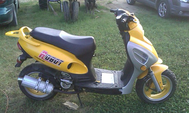

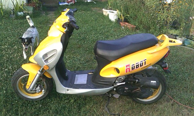

Just got in from picking up this Jonway Robot 50cc yy50qt-21, has a few consmetic flaws but no big deal. Got her off CL after i talked the dude down to 75 bucks doesnt run since the guy took the valve cover off to adjust the valves said it would start spitting and sputtering over half throttle and lose power only going 20mph. It is a 2007 with only 290 miles on it
should be an easy fix gotta make sure the valve clearance is right and get everything bolted back on etc and see if she cranks then go from there. Should be a fun project for resale
