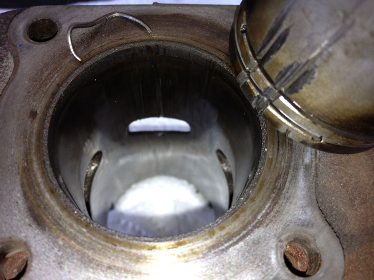

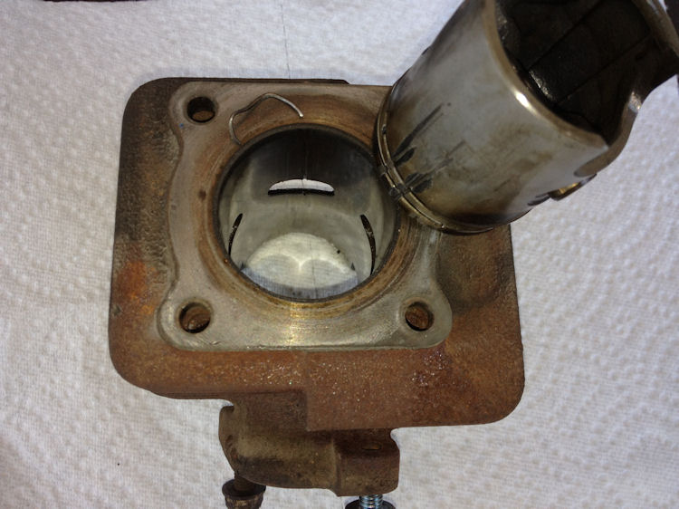

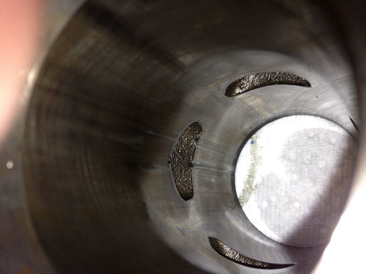

I took off the jug. The carb wasn't the problem -- it was the reused wristpin clip.

So, now I have to decide whether to junk and get something else, or rebuild. Any suggestions? Anybody have a good jug and piston for an 83 Aero 50? Any suggestions for an economical upgrade?

I took the jug to the local Yamaha shop (they do all the borings for all other motorcycle shops in the area) and they think that a .20 over boring will fix the jug. The question is whether I can get an oversize piston, or will it be more economical to buy a used piston and jug, or replace with an alternative motor. Any suggestions? Know of anyplace to get an oversize piston and rings for this model?

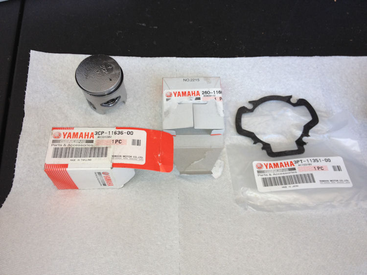

OK I took Bear's advice to heart. I went to the yamaha shop and we ordered an over bore piston (40 bore base - I believe used for the razz) bored the cylinder .20 over. We need to put it together, then we'll post the results.

Runs like a charm. So far, most of the things I needed for the 83-84 Aero I have gotten from Yamaha.
