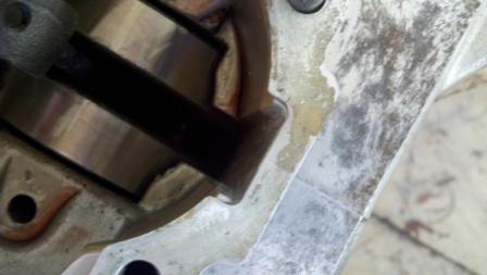

going to document my biuld.
SYM DD50 motor w/ Polini Corsa
stock intake ports
somewhat matched upper half of boost port to corsa boost port (i turned block upsidedown and used a small file)
stock intake ports

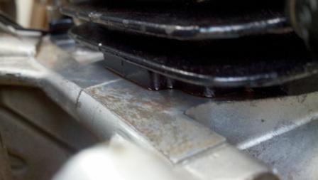

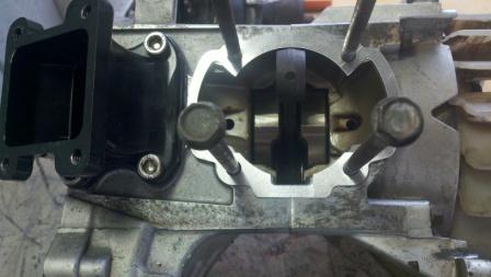

test fit everything
making sure gaskets don't interfere with eachother.
very tight fit with CT black and polini corsa. once gaskets looked good i tightened the base of the CT black (10ft lb.)
also the stock head bolts wouldn't fit in the corsa head?? 2nd time this happend to me. had to switch to stud kit.

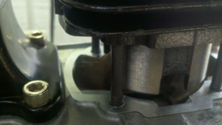

Re: DD50 corsa
test fitting cylinder for clearance (making sure it's not sitting on the layover gaket of the CT black.
actually had to dremel clearance for good fit.
even with dremel very tight fit.

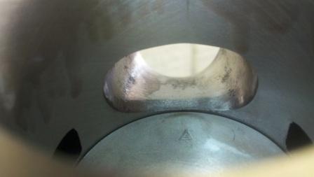

Re: DD50 corsa
cleaned all gasket surface and gasket and installed piston and cylinder.
the corsa piston seems to be (actually is by about 1/2mm eyeball/feel) below the exhaust port at BDC.
